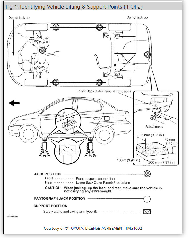

Where are the lift and jack points on the 2002 Echo?
Thanks,
John

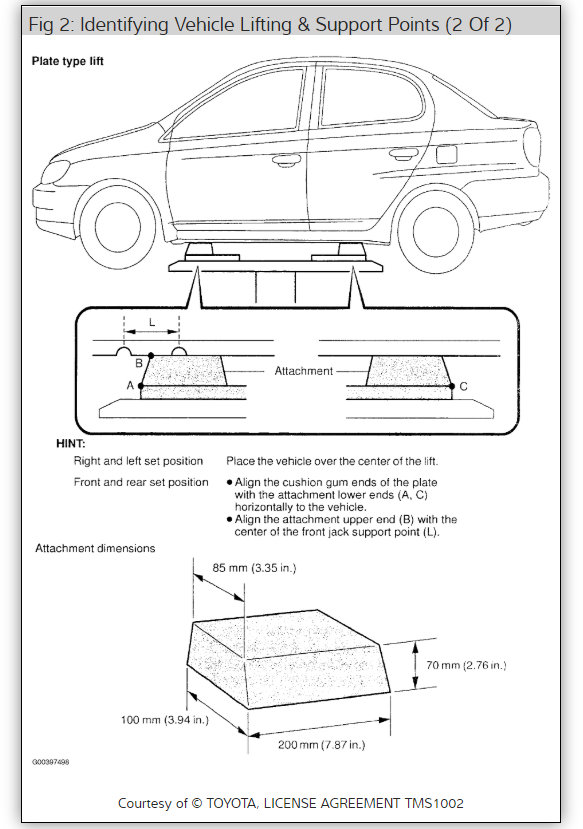

Hello
Here is a video that show how to jack up a car and diagrams below to pinpoint the locations. This video is on a similar car.
https://youtu.be/xLFn_bMkZc0
