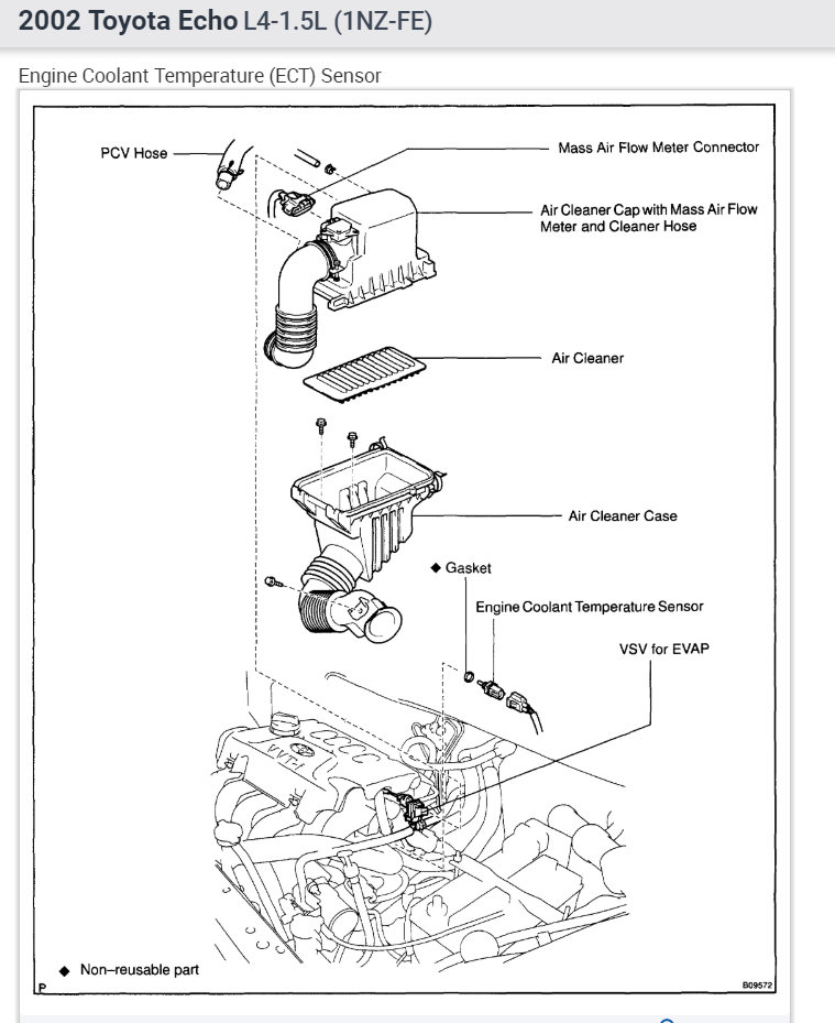

Where is the engine temperature sensor? Is it at the bottom of the rad or one the intake near the rad hose (at the top of the engine)
May 19, 2008 at 9:05 PM
  • 75,992 POSTS
Here is a guide to help walk you through the steps with diagrams below to show you the location on our car.
https://www.2carpros.com/articles/coolant-temperature-sensor-cts-replacement
