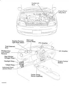

My husband replaced my daughters water pump in 2002 Echo. Now the car won't shift from park. Also no turn signal, no hazard lights, no radio, no heater or AC fan. Is there a reset switch or something? Any help is greatly appreciated. Also it starts and runs fine.

Check fuses ,alternator fuse is in common of all listed none working components
assuming he moved the alternator
check the wiring on the back of it

He has checked the wiring on the alternator, there is one that plugs in and one that attaches with a nut. Where is the fuse for the alternator? Is it in the fuse panel? Also brake lights don't work, odometer, or radio, But the headlights and horn work. Any other ideas? Thanks so much!

1st step is to check fuses since you have more than one circuit failure common supply fuse is the alternator fuse and fusible link fuses and fusible links located under hood
