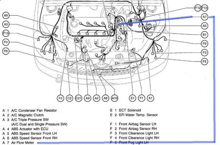

Right inline with the fresh air intake. It is bolted to the upper cap on air cleaner assy.
https://images.2carpros.com/forum/automotive_pictures/30961_echo_1.jpg

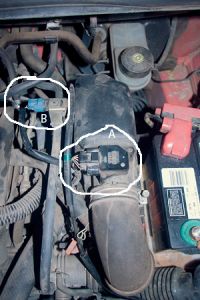

Thanks much folks, Almost there. There are two sensors there, a large one (A) on top on the ait intake, then a small one (B) "inline" with the intake going to some kind of air hose. (See the pic) Which one is it please?
https://images.2carpros.com/forum/automotive_pictures/418813_Sensors_on_echo_1.jpg

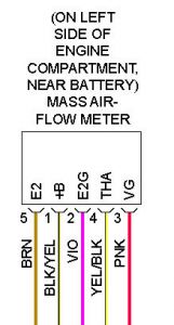

https://images.2carpros.com/forum/automotive_pictures/30961_echmaf_1.jpg

what does each code means?I'm trying to install a performance chip that requires only the sensor signal and ground
