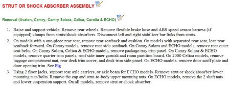

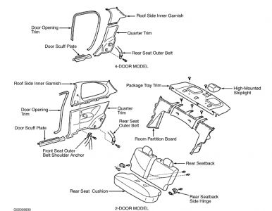

I can't locate where the top of the shock and nut is located. It seems to be a very long shock and goes into the car body itself. Where is it and how can I access the nut to remove and replace the shock?

https://images.2carpros.com/forum/automotive_pictures/261618_2_131.jpg
https://images.2carpros.com/forum/automotive_pictures/261618_Noname_2761.jpg
