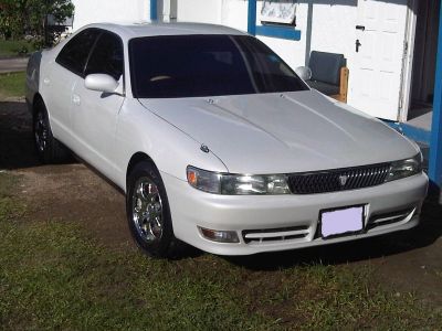

I own a 1993 Toyota Chaser which had a previous owner. I have been having the problem from I got the car. The driver window goes all the way down but sticks on the way up and it won't move for a couple of minutes. A electrician looked at it once and told me that the motor is ok. He said a little chip that is in the motor keeps overheating and cause the motor to stop. How do I fix this problem

I own a 1993 Toyota Chaser..... Its a part of the cressida family
