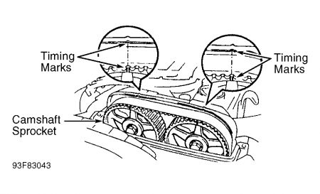

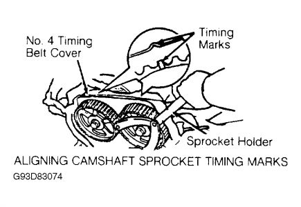

iam putting a new timing belt i just need to know which way the cams should point and the crank to put the new timing belt on thanks
