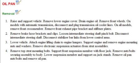

how do i take the oil pan off without removing the cross member
Sep 27, 2009 at 6:39 AM
BLUELIGHTNIN6
Experienced Mechanic
16,542 POSTS
crossmember MUST be removed..
