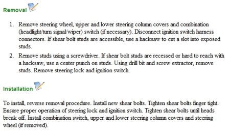

I NEED TO REPLACE THE IGNITION SWITCH CYLINDER HOE DO I DO THIS

https://images.2carpros.com/forum/automotive_pictures/261618_Noname_1903.jpg
