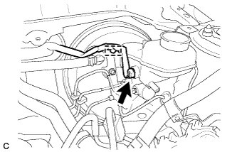

I bought this 2010 toyota corrolla 7 days ago. Sometimes, as I drive, and I haven't applied brakes for a few blocks or so, the brake pedal goes within an inch of the floor. 4days after purchase I took it to the dealer/service. The mechanic drove it and said they were fine and normal. Now, three days later, it did it again. If I pump it, the pedal doesn't go as far to the floor. the service manager said , "Yeah the brakes are squishy on that model but they are okay." I don't believe him. They don't feel safe. Is an intermittant "one inch to the floor normal"?

hi,
that is not a normal condition for any vehicle. if the pedal is going nearly to the floor, but you can pump it up and get a solid pedal, first confirm there are no leaks under the vehicle. check brake lines and at each wheel. if the brake master cylinder is full and it still happens, chances are the brake master cylinder is bad.
take a look through this link:
https://www.2carpros.com/articles/brake-pedal-goes-to-the-floor
what actually is this. the plungers in the master cylinder begin to harden or wear. as a result, brake fluid can bypass them. the result is the pedal going to the floor.

remove brake master cylinder sub-assembly
disconnect the connector and disengage the clamp.
pic 7

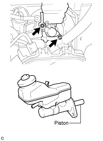

using a union nut wrench (10 mm), disconnect the 4 brake lines from the brake master cylinder sub-assembly.
pic 8
remove the 2 nuts, brake tube way and brake master cylinder sub-assembly.
pic 9
notice:
the master cylinder requires careful handling. do not allow the master cylinder to receive any impact, such as from being dropped. do not reuse a master cylinder that has been dropped.
do not strike or pinch the master cylinder piston, and do not cause any damage to the master cylinder piston by any other means.
make sure to release the vacuum from the brake booster before removing the master cylinder from the brake booster.
when installing the master cylinder to the brake booster, or when removing the master cylinder from the brake booster, make sure that the master cylinder is kept horizontal or its tip faces downward (the piston faces upward) to prevent the master cylinder piston from falling off.
do not allow any foreign objects to contaminate the master cylinder piston. if a foreign object gets on the piston, remove it by using a piece of cloth and then apply an even layer of lithium soap base glycol grease around the circumference (sliding part) of the piston.
do not use any other type of grease or fluid.
remove the o-ring from the brake master cylinder sub-assembly.

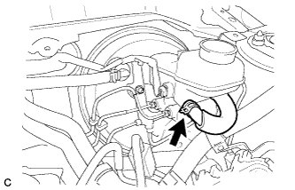

install brake master cylinder sub-assembly
install a new o-ring to the brake master cylinder sub-assembly.
install the brake master cylinder sub-assembly and brake tube way to the brake booster assembly with the 2 nuts.
pic 10
