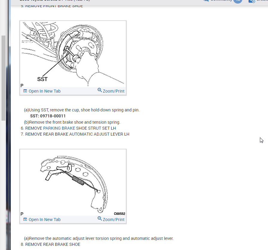

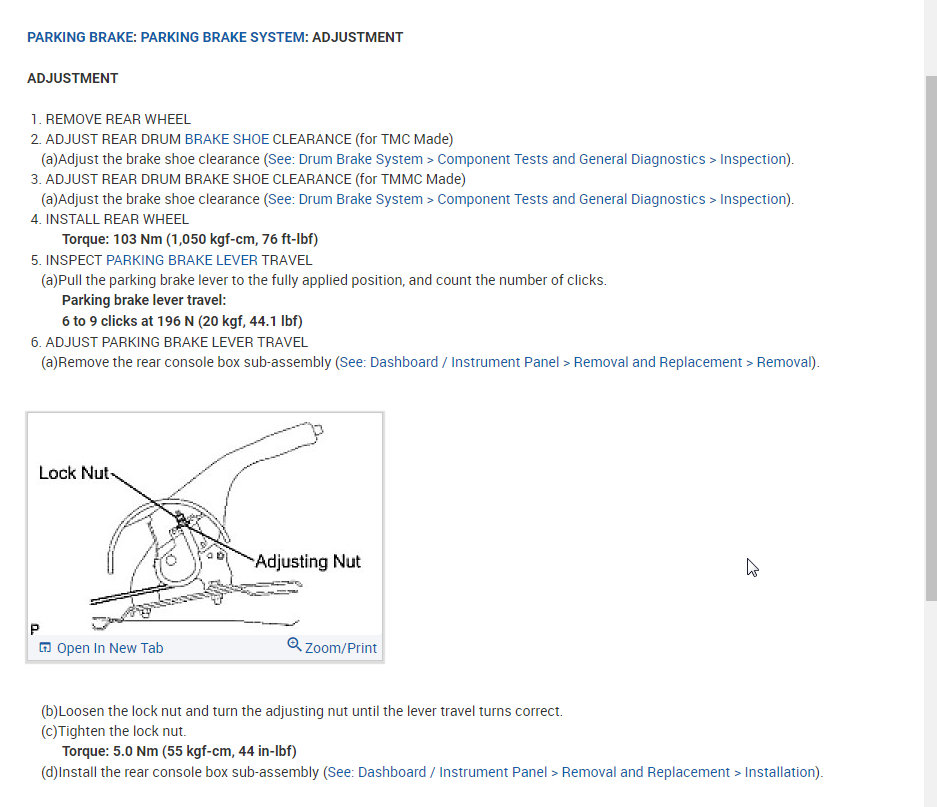

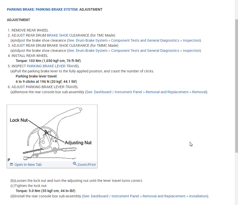

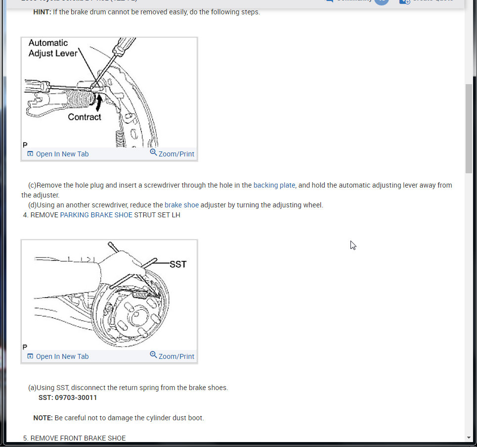

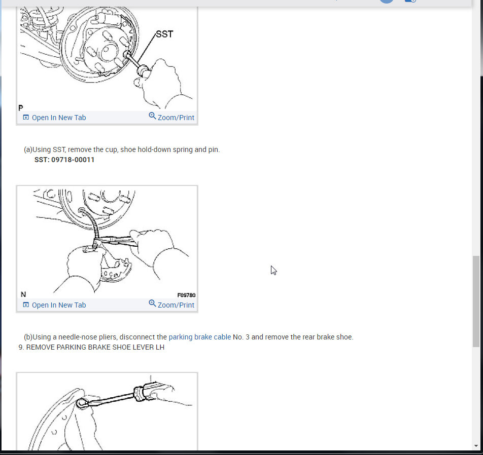

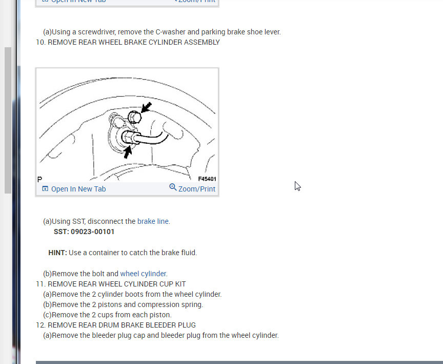

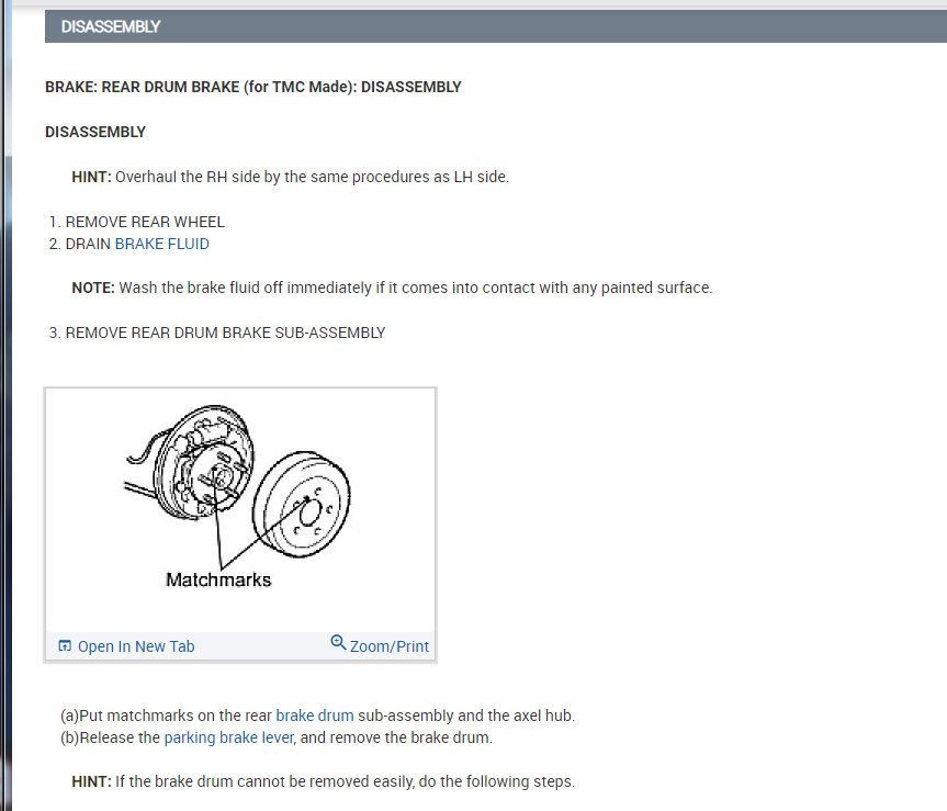

I changed the brakes on my car sometime last fall and now I'm hearing a grinding sound coming from the rear parking brakes I'm not sure the proper torque.
Jul 21, 2010 at 1:00 PM
Here is a guide that will take you through this repair:
https://www.2carpros.com/articles/parking-brake-shoe-replacement

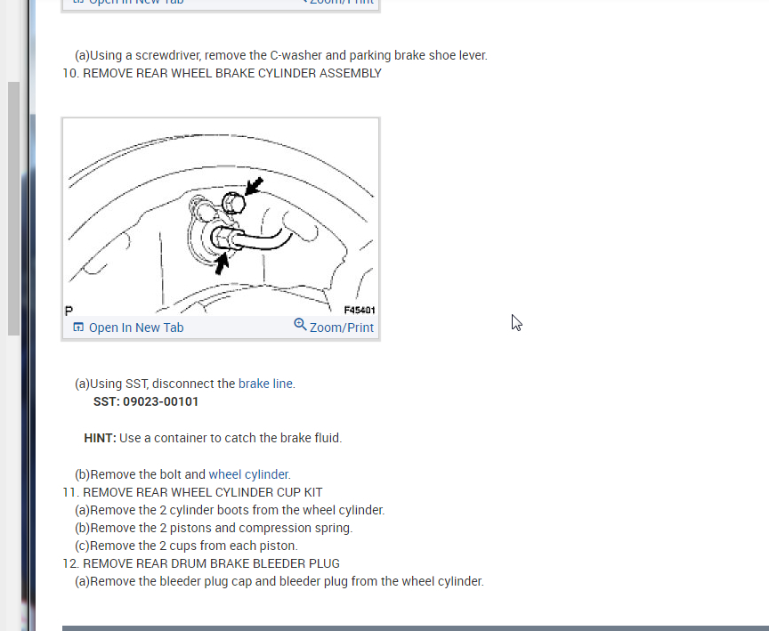

Below you will find the process from the manual that will help get the info needed for this. Please let us know if there are questions and we can go from there. Thanks
