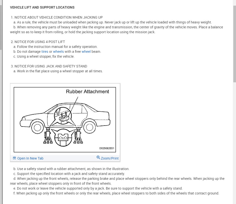

Where are the jacking points on my car?
Mar 30, 2009 at 4:41 AM

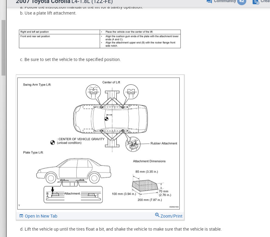

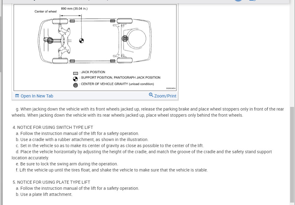

Here is a guide that will help with how to do this. On these vehicles there are normally cut out in the pinch weld that will be the placement of the jack but let's run through this guide and then I will attach the info from the manual below:
Take a look at this info attached. Please run through this and let us know what questions you have.
