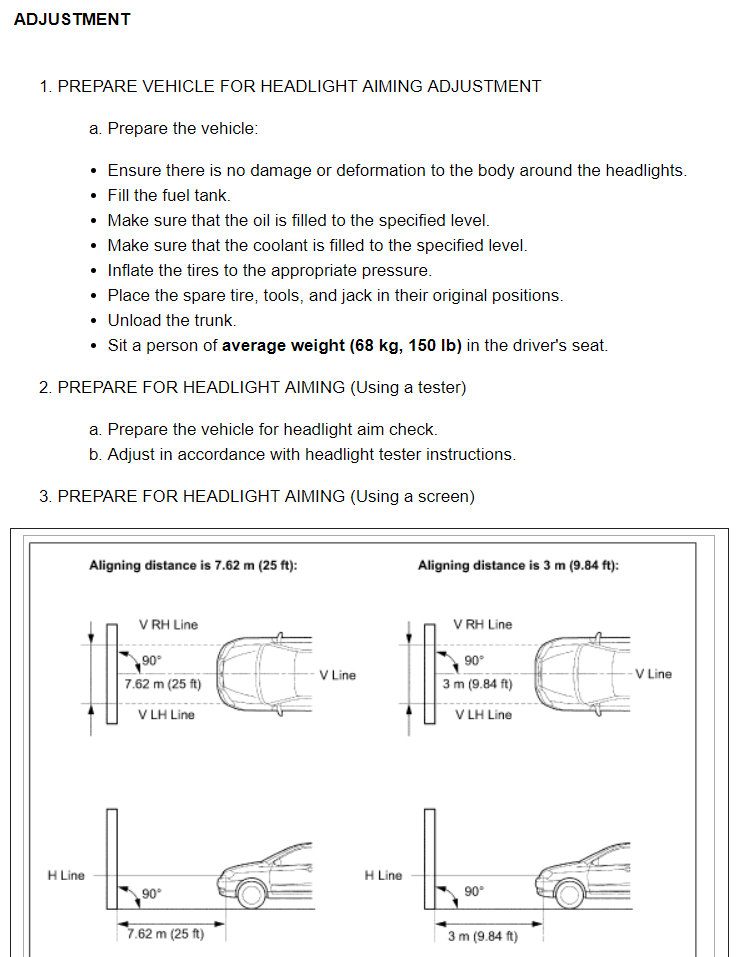

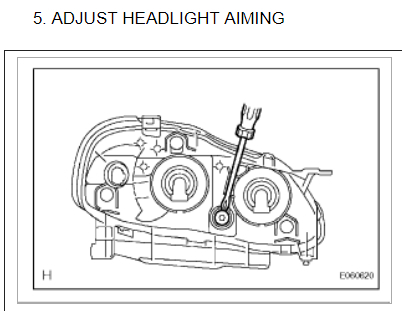

adjust the headlights?
2007 TOYOTA COROLLA
PREACHER BOOM

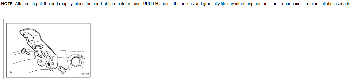

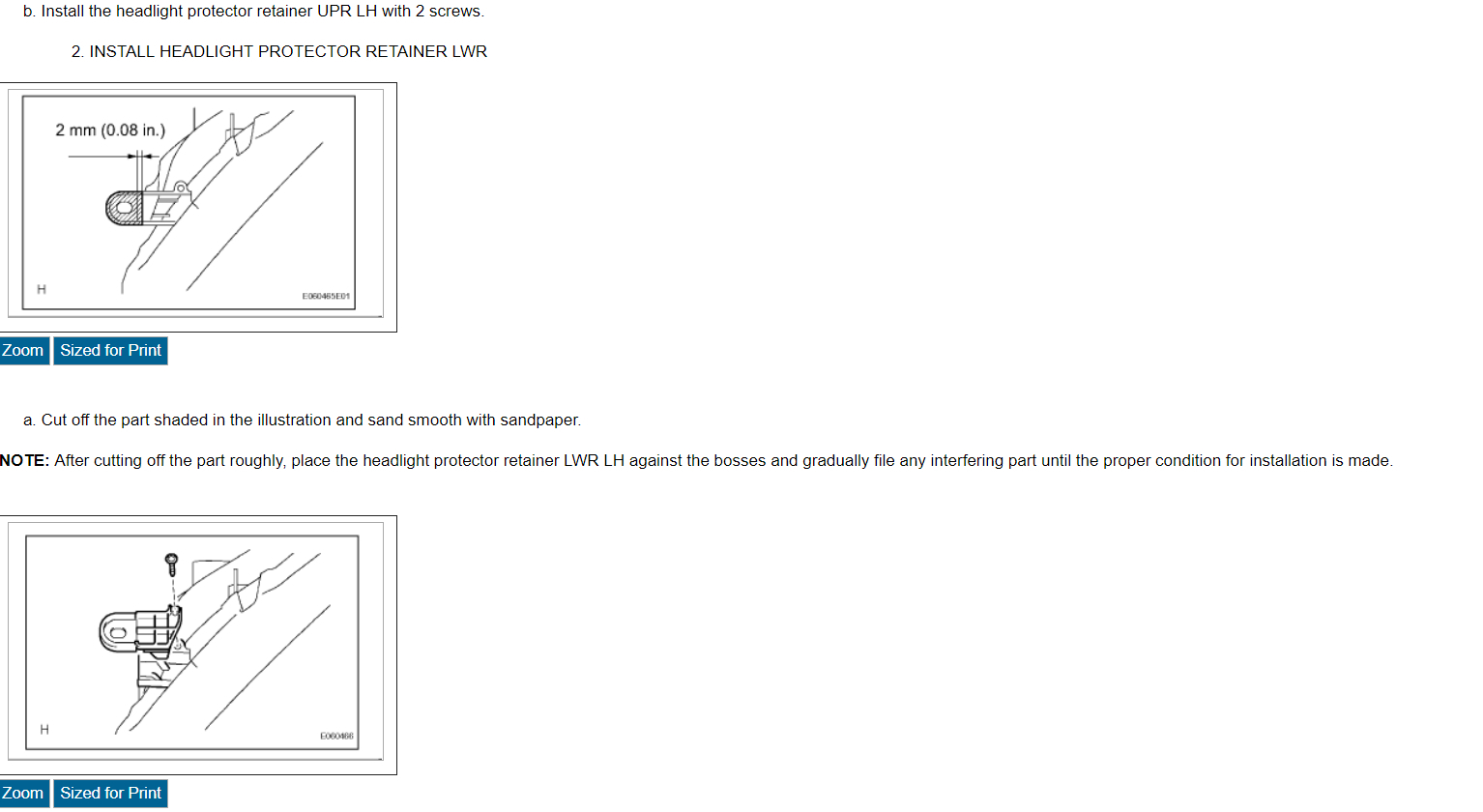

I have been to numerous websites and to autozone and cant seem to find out how to adjust them up a bit if you could please help i would appreciate it thank you
Jul 29, 2008 at 9:51 AM
KHLOW2008
  • CAR REPAIR CONTRIBUTOR
  • 41,814 POSTS

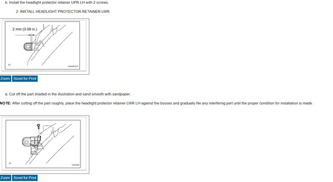

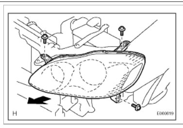

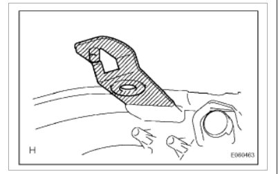

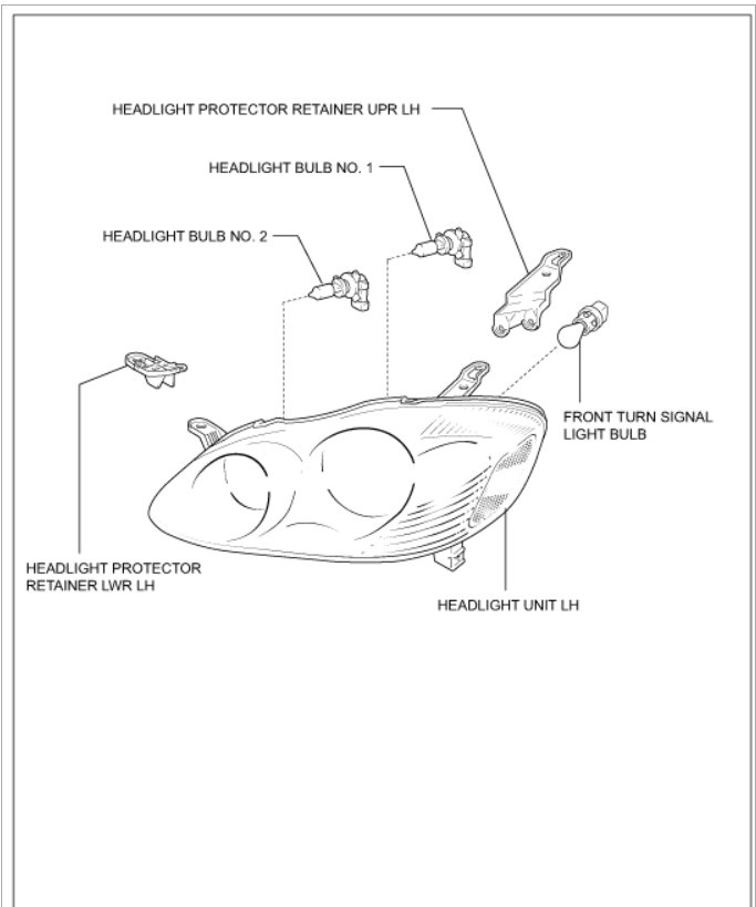

Hi Preacher,

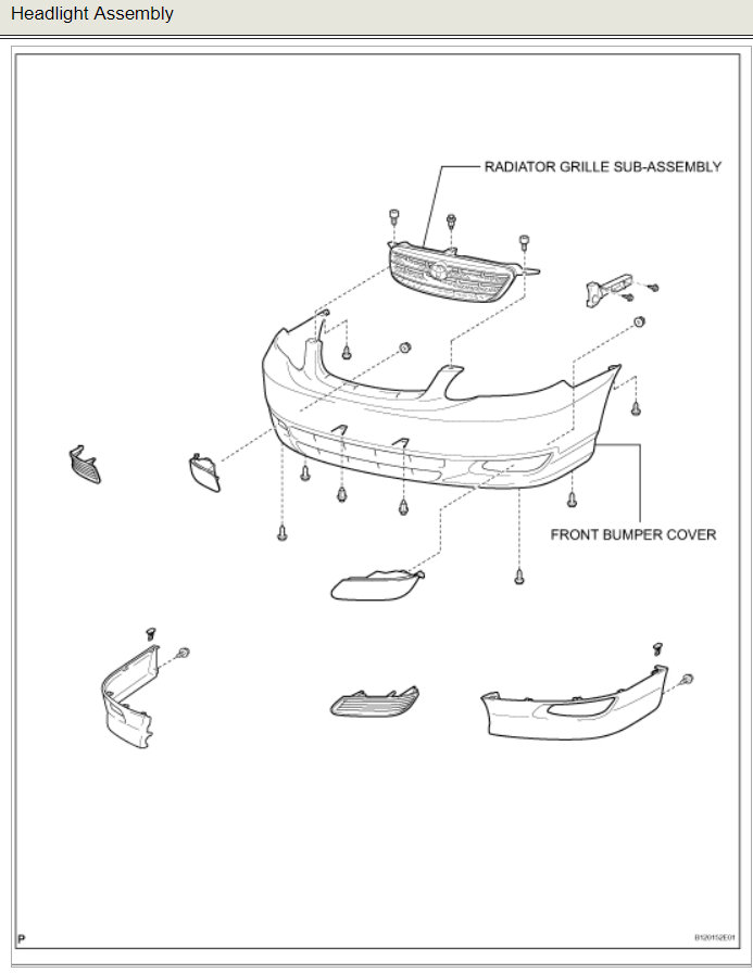

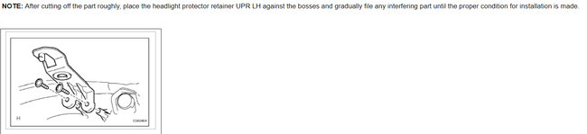

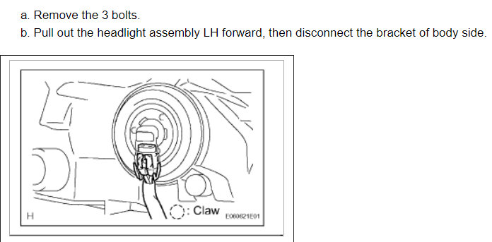

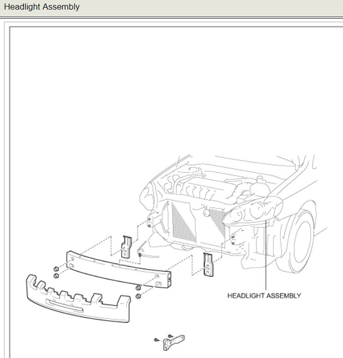

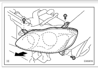

The adjust aim screw are shown in diagrams below. Here are all diagrams for adjusting the headlights and a guide to walk you thought he steps on how to replace the headlight lens with diagrams below to show you on your car.
https://www.2carpros.com/articles/headlight-lens-replacement
Check out the diagrams (Below) Please let us know if you need anything else to get the problem fixed. Cheers
