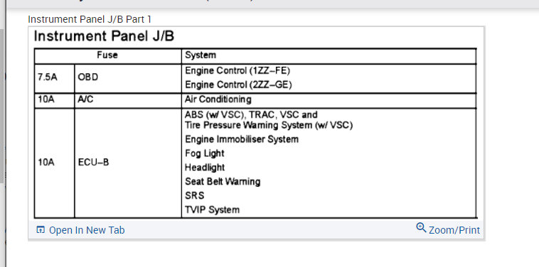

I was recently got involved in accident which forced the panel. Now the lights dont work I need to check the fuses.
Apr 18, 2010 at 7:18 PM
Here is a guide that will help with step by step with this process:

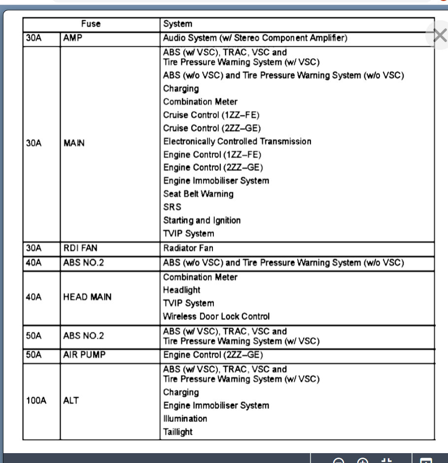

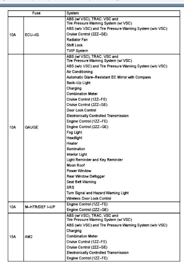

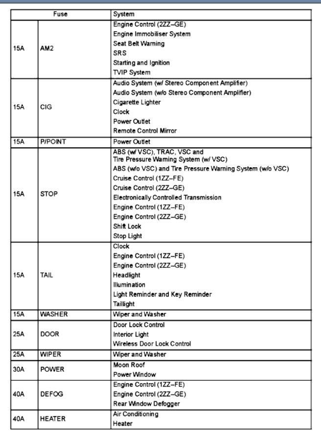

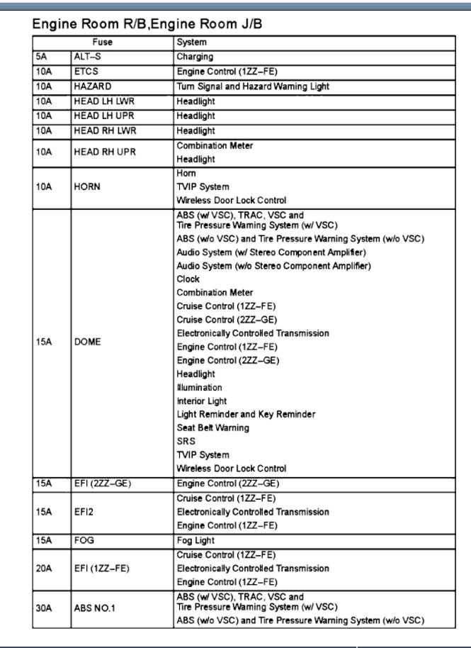

Below are the charts that you will need for the fuse descriptions. Please let us know if you have other questions. Thanks
