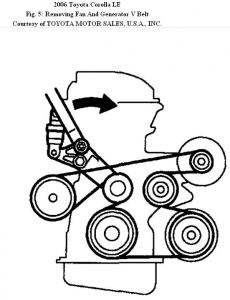

I do not see a place for a breaker bar to releave pressure off an idler pulley, or the adjustment to one of the other pulleys to allow for the belt change. Where do I find the adjusment pulley so to change the serpintine belt?

Hi pistolgrip, Thank you for the donationo. On the autotensioner there is a bolt head (19 mm) that you can use as leverage to loosen the tensioner to remove the belt. Turn it clockwise to release the tension.
