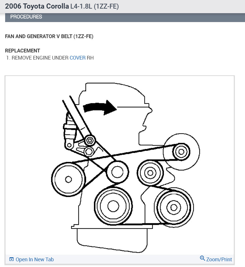

I brought my car to the dealership to get an oil change and asked them to check the belts. My car makes a VERY MINOR squealing noise occasionally in the morning when it is cold and I start it, but goes away immediately. Of course, they say the belt and the tensioner need to be replaced, along with the normal laundry list of "suggested" (ie expensive) services.My husband and I do not believe this is the actual problem, as my husband said the sound would be much worse and frequent if that was the case. Does this seem like a problem my car could have with only 73000 miles on it?

It is possible that the tensioner/belt need to be changed, unusual on an '06 but possible.
I would have the tensioner and belt changed, and make sure you tell Toyota that you expect this repair to stop the squeak.
As far as the laundry list. Check the owners manual for scheduled maint. if it is on their list but not on the factory maint. schedule, point that out to Toyota.
REPLACEMENT
1. REMOVE ENGINE UNDER COVER RH
2. REMOVE FAN AND GENERATOR V BELT
a. Turn the drive belt tensioner clockwise to relieve tension on the belt, and then remove the belt.
b. Carefully return the tensioner to the unloaded position.
NOTICE:
^ Be sure to connect SST and the tools so that they are inline when using.
^ When retracting the tensioner, turn it clockwise slowly in 3 sec. or more. Be sure to not apply force rapidly.
^ After the tensioner is retracted all the way, do not apply force any more than necessary.
