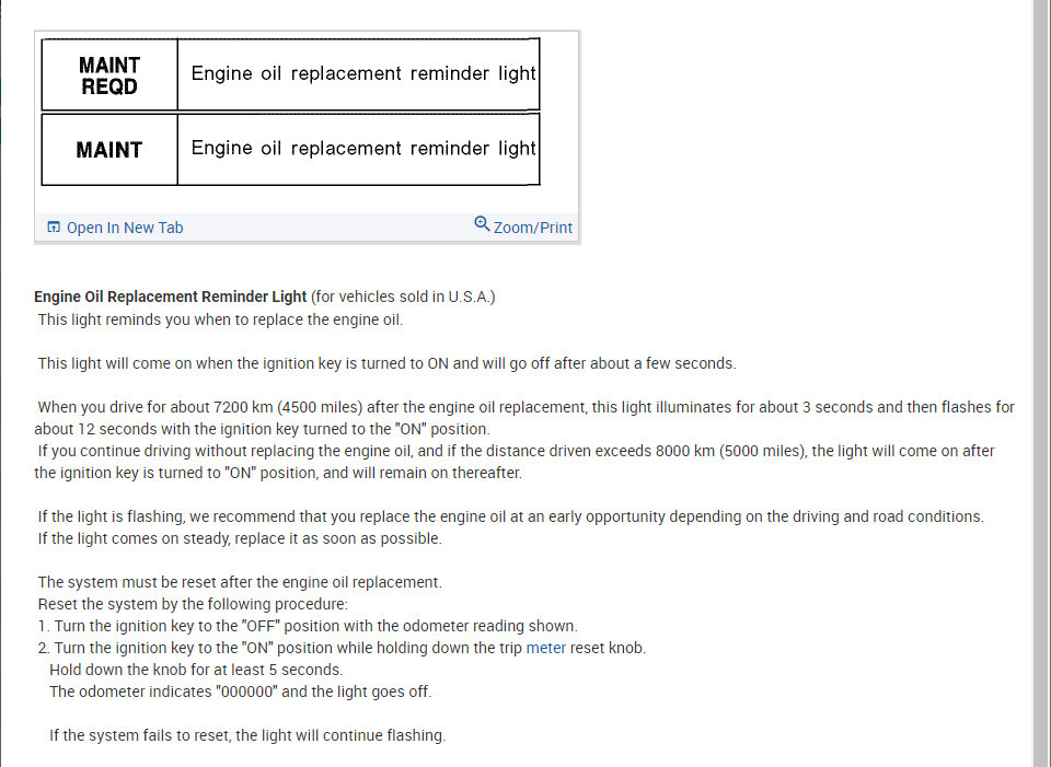

Service engine light is on - oil has been changed. How do you reset the service engine light?
Apr 13, 2010 at 10:26 AM
Unfortunately this is missed many times by dealers and shops and a very popular topic.
Here is a guide that will help with this:
https://www.2carpros.com/articles/oil-life-reset
I attached the process from the manual below on how to reset this on your vehicle.
Please run through this material and let us know if you have other questions. Thanks
