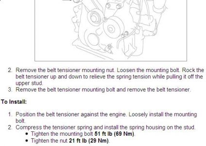

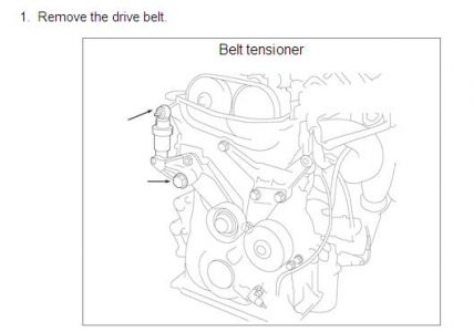

How do you replace a Belt Tensioner in an o6 toyota corrola and is it easy to do?

JDL
Experienced Mechanic
16,098 POSTS
Oct 21, 2009 at 7:10 AM
