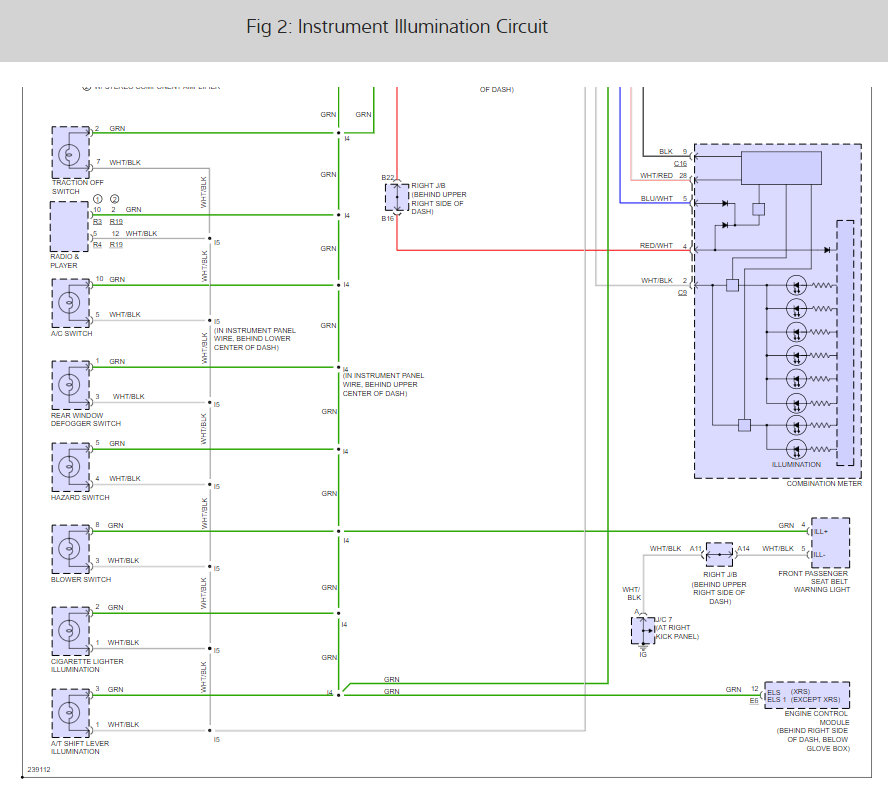

Dash lights have gone out so I can not see anything at night. At first my radio was also out but after checking every fuse in the car it is now working but not the dash or radio lights. Is it possible the lights themselves have died? How do I change those?

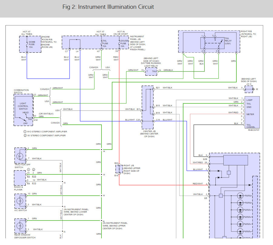

It sounds like the headlight switch is bad but to be sure lets use this guide and the instrument cluster wiring diagrams below to help find the problem see where you are losing power.
Check out the diagrams (Below). Please let us know what you find. We are interested to see what it is.

Thank you for this post I had to replace the headlight switch all fixed cost me $78.00 for the switch BTW
