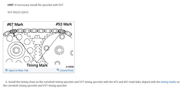

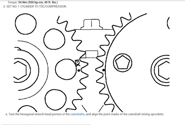

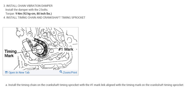

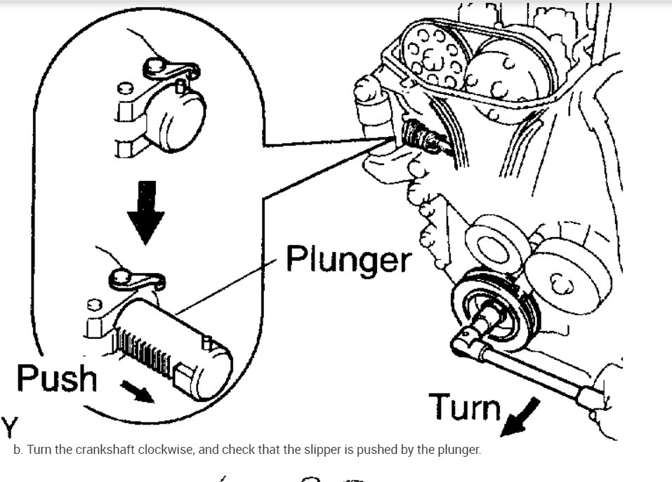

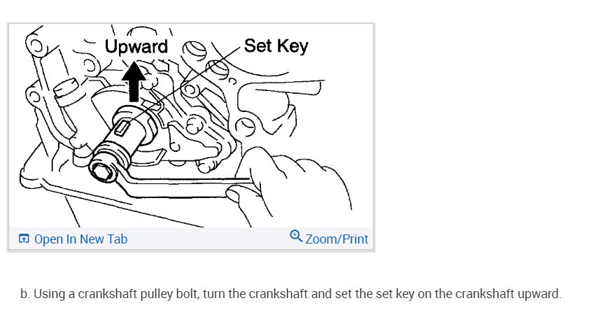

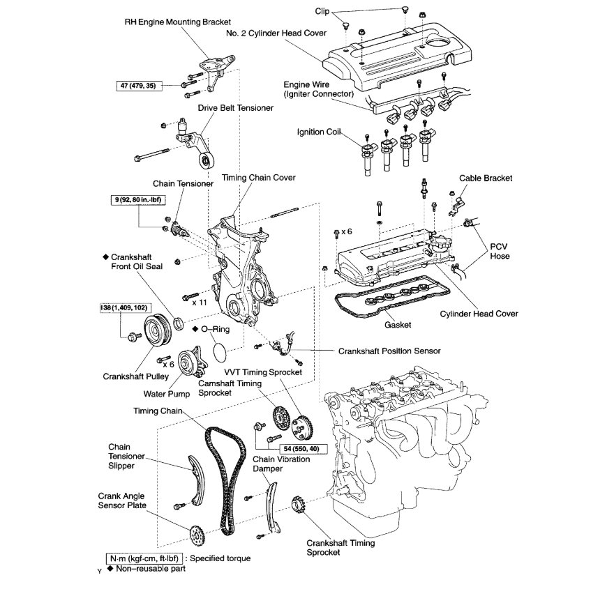

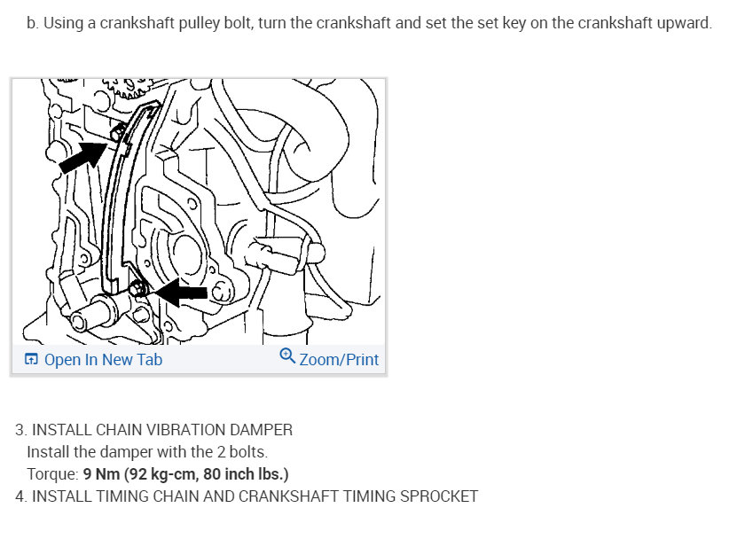

what is the use of Camshaft timing oil control valve? is there any problem if i use the car without working Camshaft timing oil control valve ? Also I need the camshaft timing as well.
Mar 7, 2009 at 7:49 AM
MMPRINCE4000
  • 8,548 POSTS
It is used in conjunction with the VVTi system, similar to the Honda variant VTEC.
They provide more power (lift and duration) at higher RPM.
I would not take the chance of not using it, since the system is designed for it and it would either set an error code or cause an oil starvation problem. Here are the camshaft timing marks. Check out the diagrams (Below). Please let us know if you need anything else to get the problem fixed.

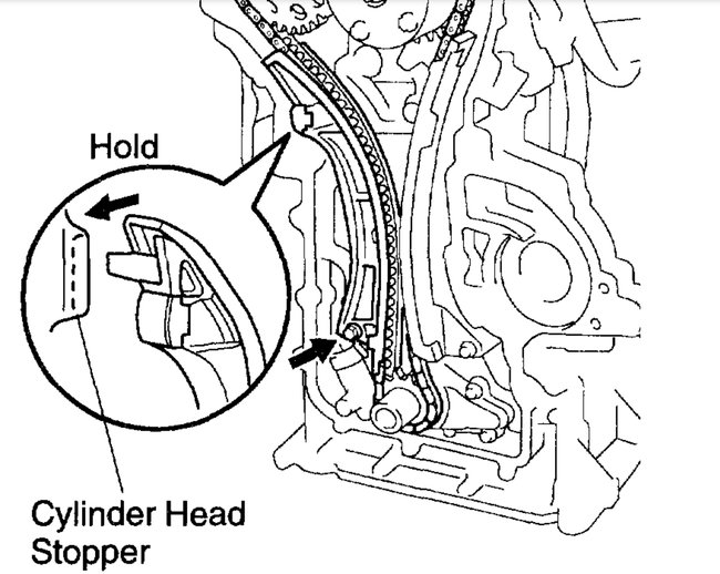

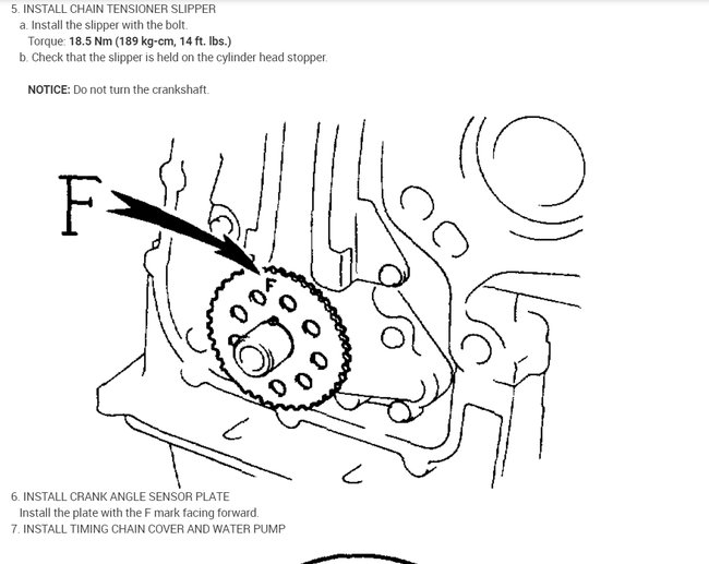

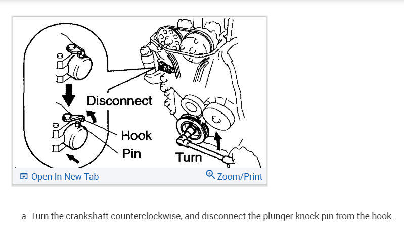

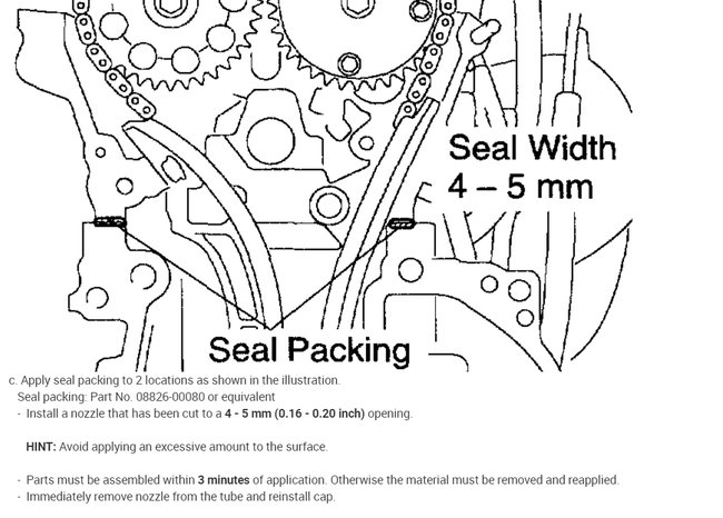

Engine Mechanical problem
2002 Toyota Corolla 4 cyl Automatic
i'm looking for a diagram or picture of the marks or ponts of the chains to when installing the time belt in my toyota corolla.

BLUELIGHTNIN6
  • 16,542 POSTS
https://images.2carpros.com/forum/automotive_pictures/261618_Graphic_355.jpg
https://images.2carpros.com/forum/automotive_pictures/261618_Graphic2_51.jpg
https://images.2carpros.com/forum/automotive_pictures/261618_Graphic3_8.jpg
Oct 14, 2020 at 1:06 PM (Merged)
