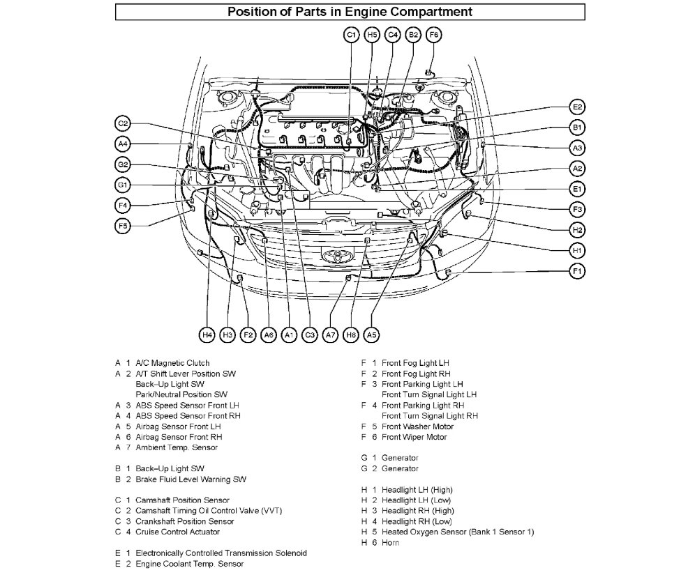

My wipers work but the washer fluid won't dispense. I have replaced the fuse. Would I need to replace a motor or a pump?
Wednesday, January 6th, 2010 AT 4:08 PM
5 Replies
MMPRINCE4000
  • 8,548 POSTS

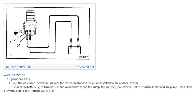

It sounds like the pump motor is bad which is common here are the instructions on how to replace the pump motor in the diagrams below. (F5) Check out the diagrams (Below). Please let us know if you need anything else to get the problem fixed.

Remove the washer bottle and the pump is located at the base, its fitted into a rubber seal ring, it will come out fairly easily, (or it should)

First thing to do is to check if the motor is buzzing when activated. That could mean the motor is working but water is not getting sprayed due to clogging of lines or leakages between motor and nozzle.
