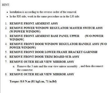

how do i take off right side mirror
Apr 9, 2010 at 3:39 AM
BLUELIGHTNIN6
Experienced Mechanic
16,542 POSTS
Apr 9, 2010 at 4:48 AM
