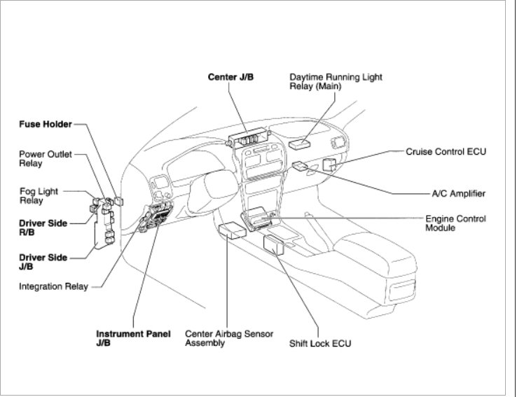

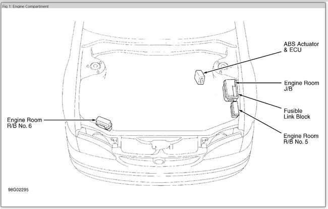

Four cylinder front wheel drive automatic 91,000 miles.

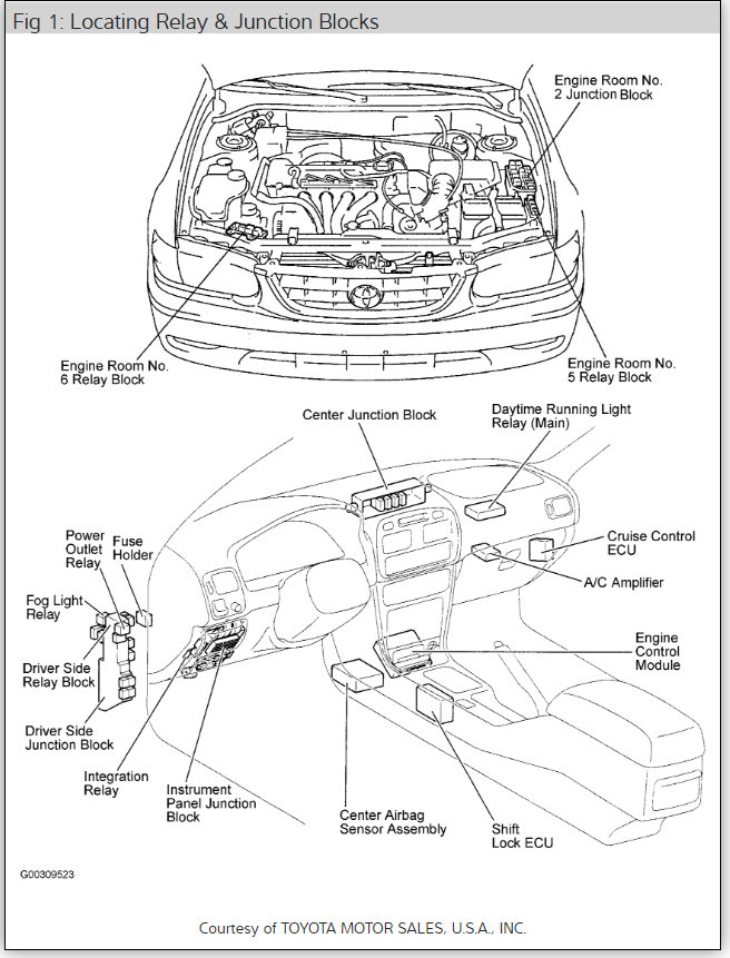

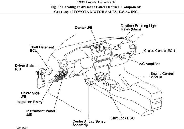

The radio and clock went off at the same while driving. The emergency flashers, cigarette lighter and cell phone outlet now do not work either. The air circulation fan, the switch is just below the radio, continues to work. I have checked the fuses under the hood according to the owners manual; they all appear continuous. My Haynes Repair Manual says there is another fuse box located at the left end of the instrument cluster, but the only thing I find is a flip out storage box there. What am I missing?
Also, could a cheap cell phone charger have caused this problem? This occurred after my daughter's eBay purchased charger was used in the cigarette lighter. She says the same thing happened to her Subaru after she used the charger.
I have problem finding the fuse box on same car 2002 Corolla. I took out the storage compartment beside steering wheel and it looks like it was removed because I cannot see it. Any ideas please?
Thanks for a reply.

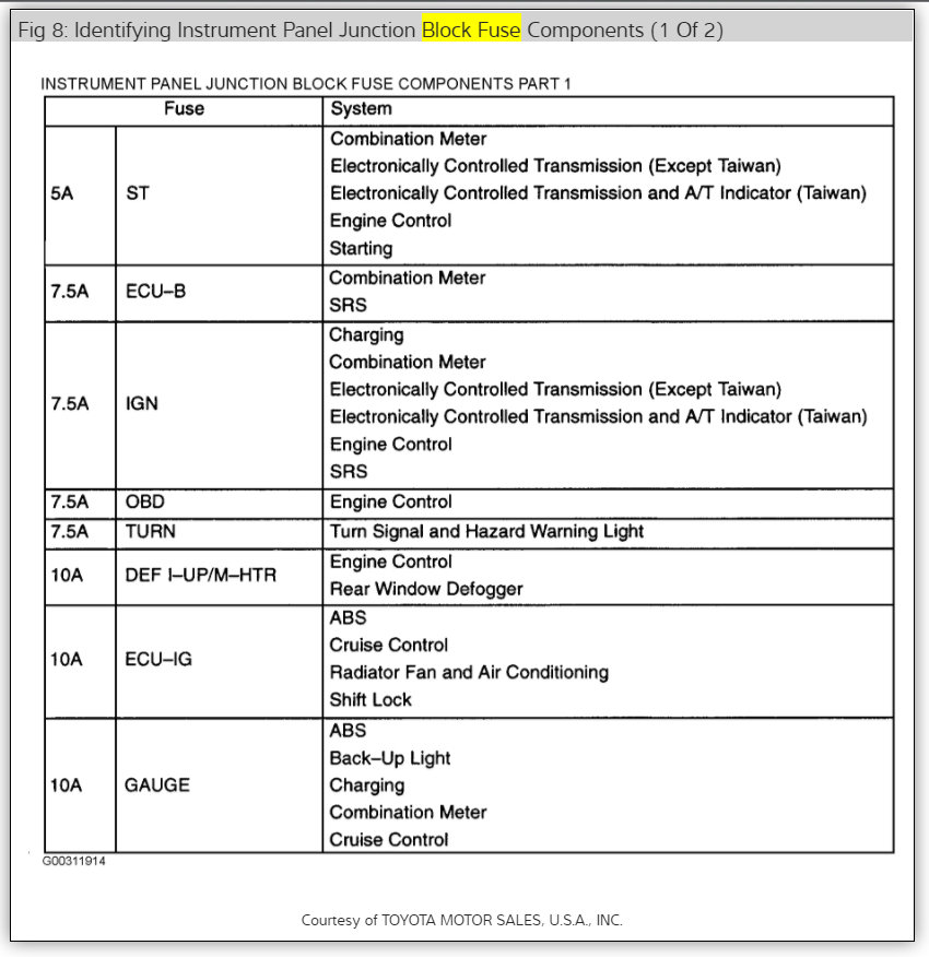

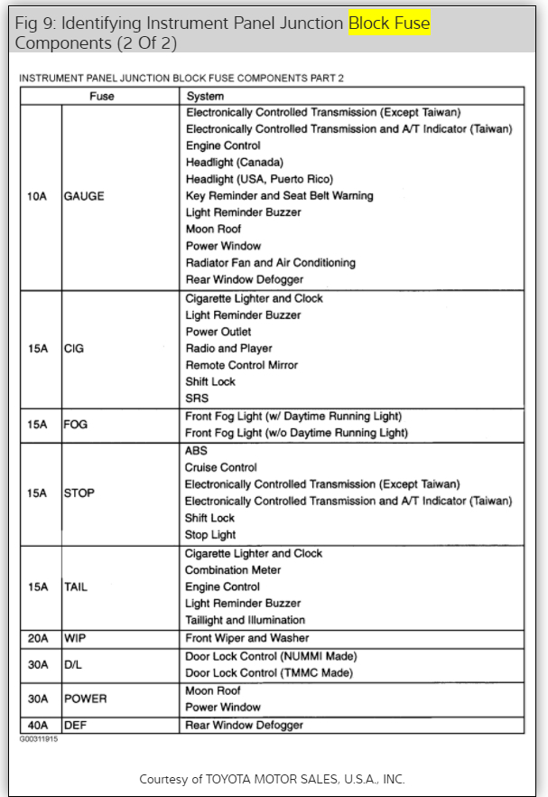

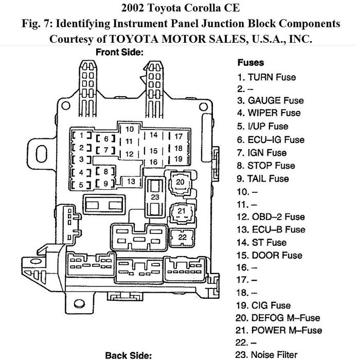

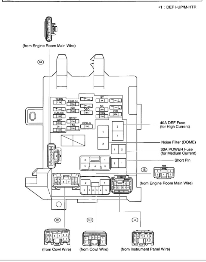

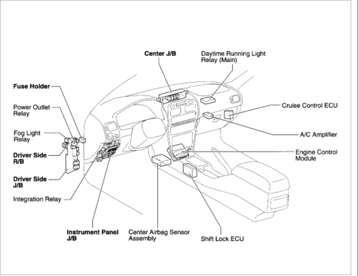

Hi StarMagellan,

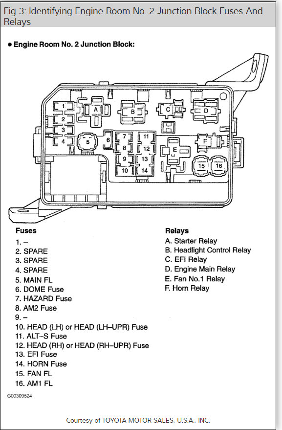

2002 Corolla inside fuse box location Left of steering wheel, behind "storage only"
compartment.
Radio fuse is - Fuse #31, right side, third fuse down.
It is a Type "A" fuse - controls radio, clock, cigarette lighter.
Under the dash in instrument panel junction box on driver side.
Here is some diagrams and wiring so toy can do some testing:

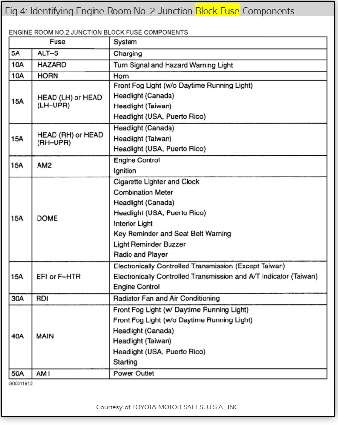

5 - DOME 15 Amp Car Audio System, Interior Light, Personal Lights, Trunk Light, Clock, Daytime Running Light System, Theft Deterrent System

31 - CIG 15 Amp Car Audio System, Clock, Cigarette Lighter, Power Rear View Mirrors, SRS Air Bag System, Seat Belt Pretensioners, Automatic Transmission Shift Lock System, Theft Deterrent System

Please run some tests and get back to us so we can continue helping you.
check out the fuse and wiring diagrams (BELOW)

First check with a test light that you have power going into the fuse and out the fuse. sometimes the fuse can look okay but still be blown. let me know what you find.

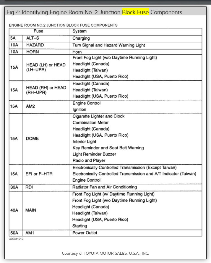

1989 Corolla wagon 1.6 liter, two barrel carburetor. The radio, clock and overhead lights stopped working. Fuse is good. What else could cause this problem?
Jan 4, 2017 at 1:53 AM (Merged)
KHLOW2008
  • 41,814 POSTS

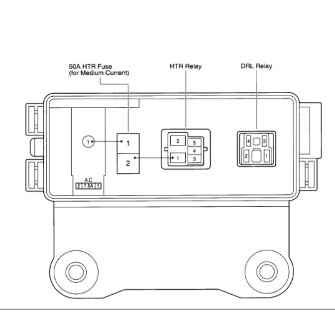

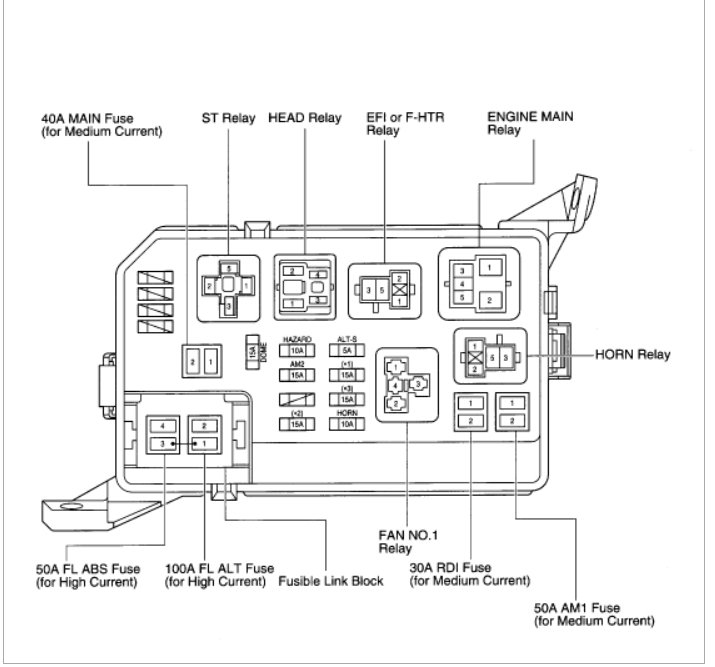

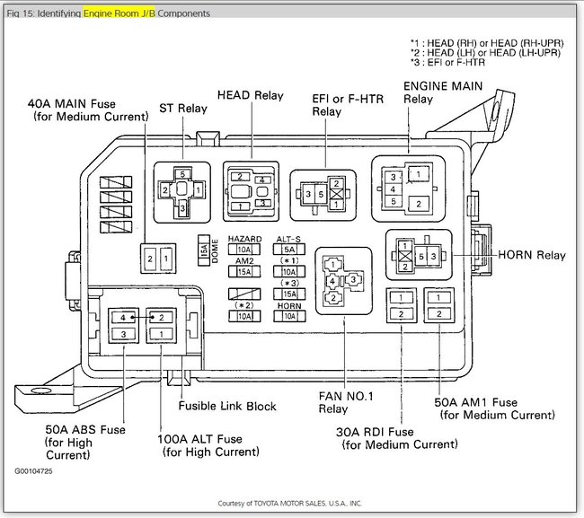

Did you check the dome fuse in under-hood fuse box?
POPROCKS4U
After your reply, I checked the fuse you mentioned in your response and it was blown. Thanks! I replaced it with a 7.5 A and the lights and "radio" are working. I will get some 10 Amp fuses later.

Where is the fuses for a 2002 corolla windshield wipers located?
Oct 22, 2018 at 1:35 PM (Merged)
KHLOW2008
  • 41,814 POSTS

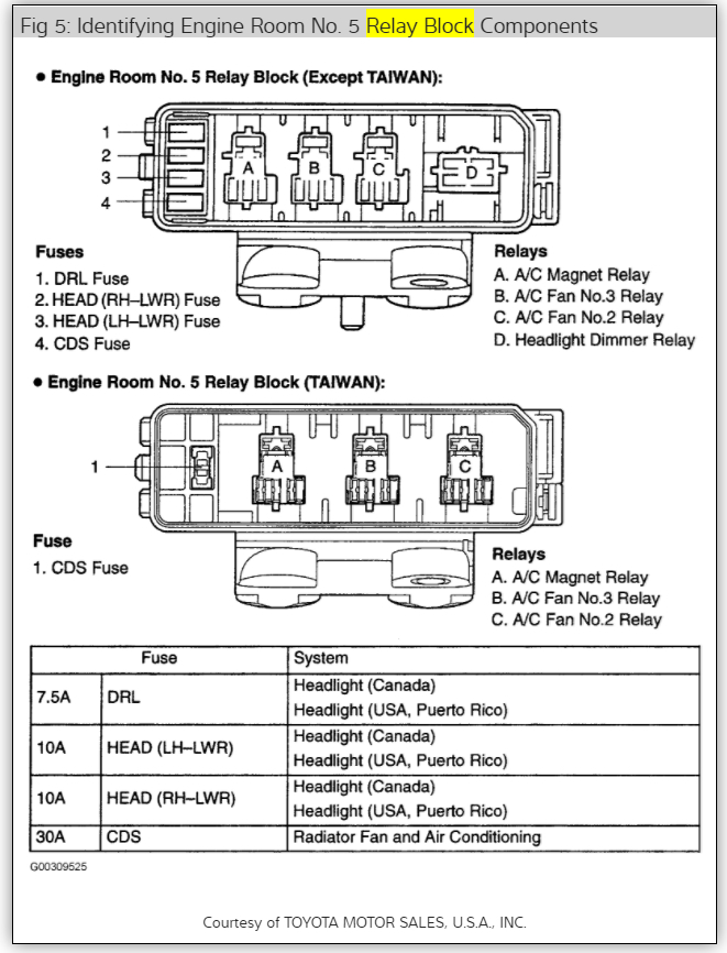

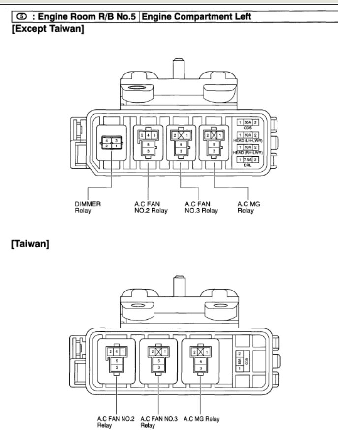

The fuse for the wipers is (Fuse # 4 under dash) Here is a guide to help you check for power and the fuse locations below.
Check out the diagrams (Below). Please let us know if you need anything else to get the problem fixed. Cheers

ALLENGADSDEN
Where is the fuse box located on the 2002 Toyota corolla
MMPRINCE4000
  • 8,548 POSTS

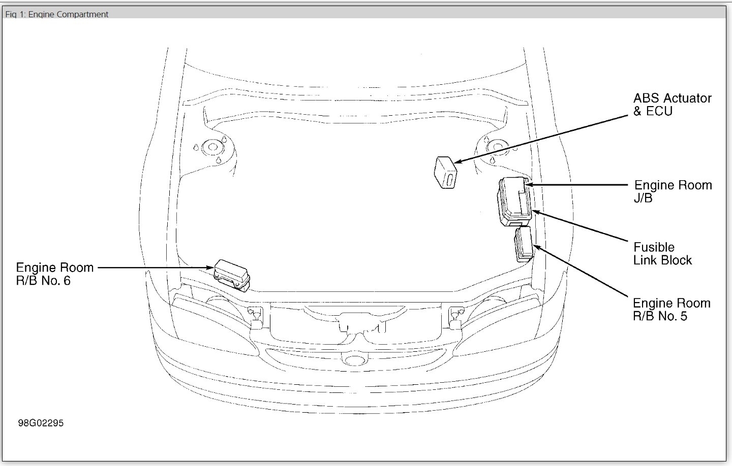

Open drivers door, fuse panel is behind panel near the door hinges.

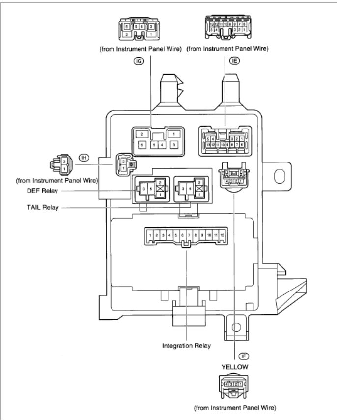

DARG49
  • 44 POSTS

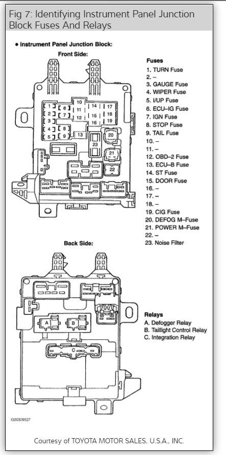

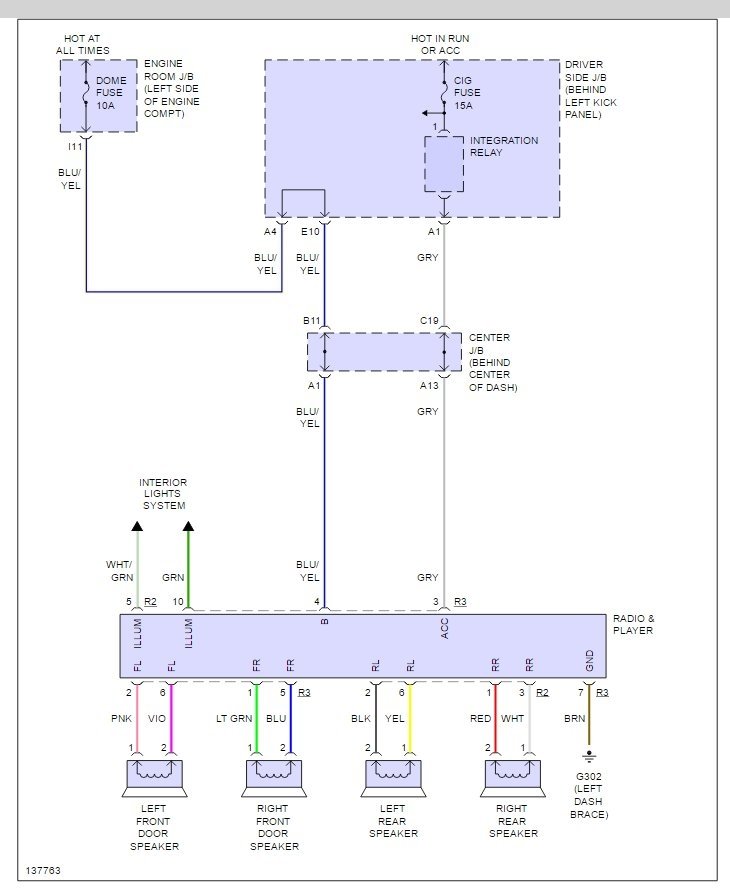

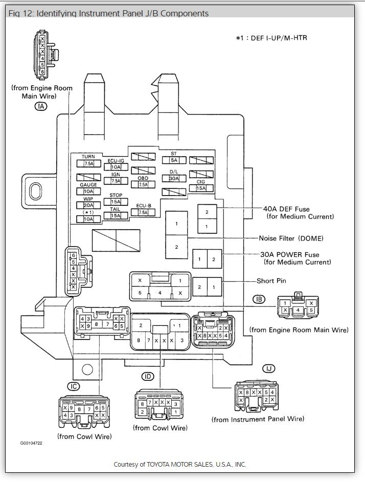

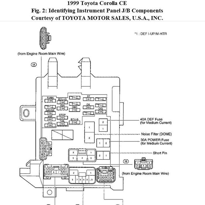

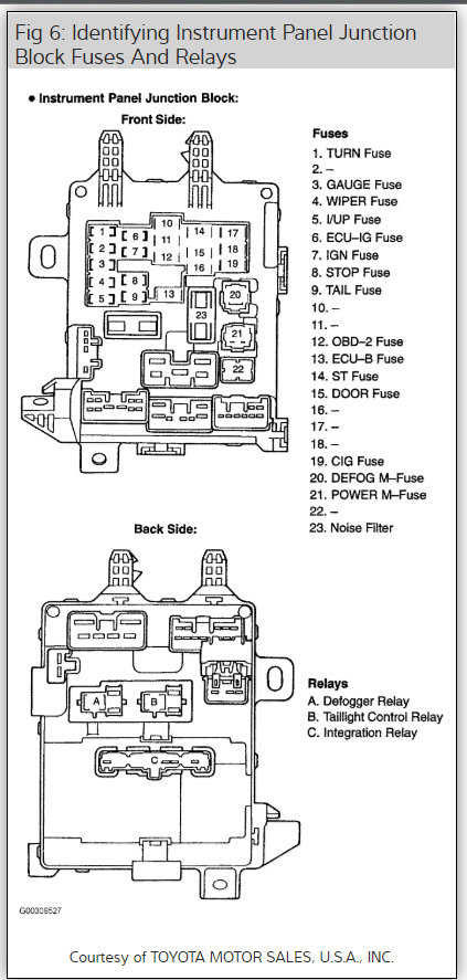

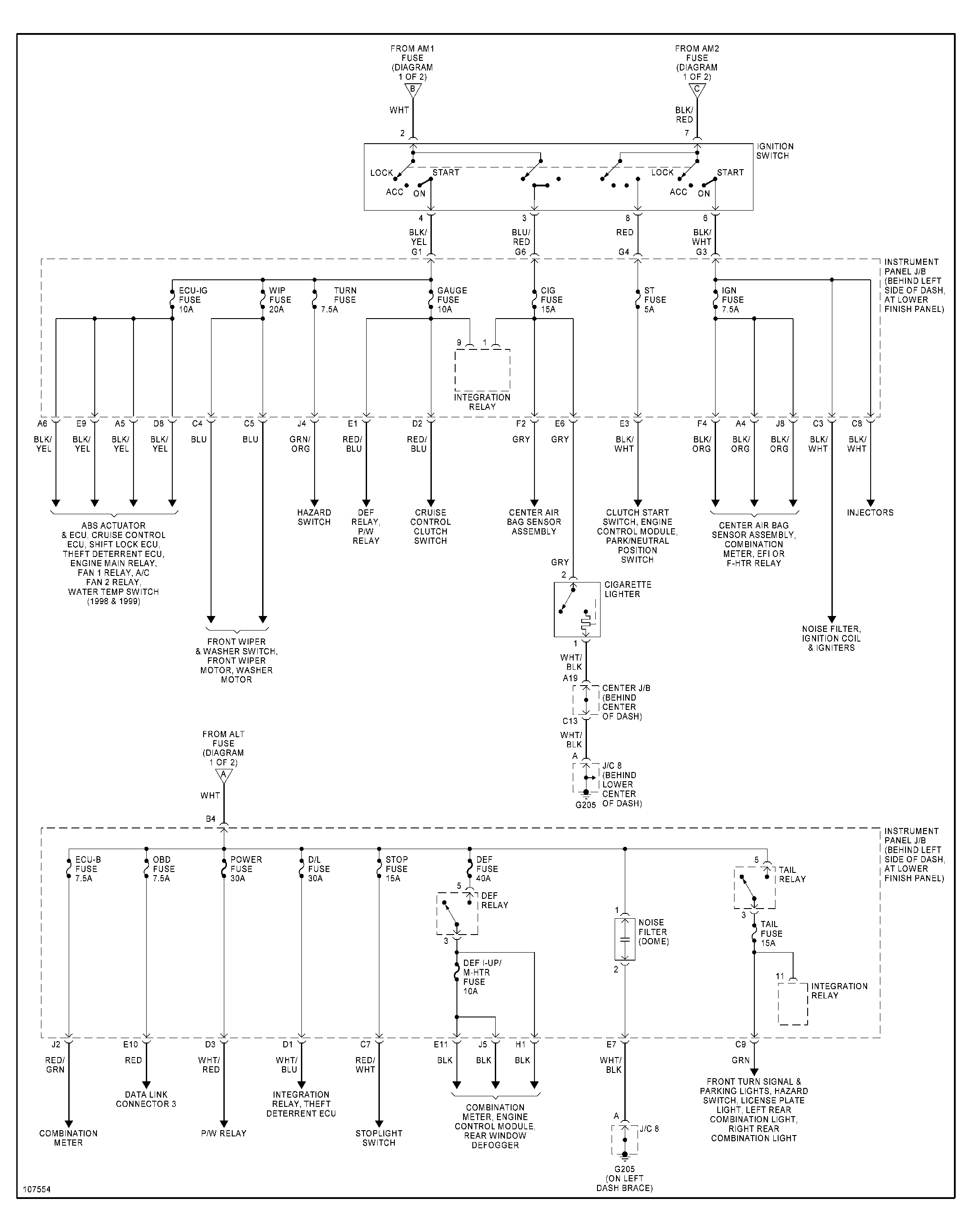

Dash lighting, cigarette lighter, license plate lighting, tail lights all of a sudden no longer work, but where is fuse for all that located? Had one light on dash lighting go out years ago and have been fine without it. Have a Haynes repair manual which doesn't seem to help much with this problem.
  • 110,244 POSTS
It is located behind the left side of dash at lower finish panel. I attached a schematic. Please note, the power to this fuse box comes from a main fuse box under the hood.
DARG49
  • 44 POSTS
Thank you, I had already found that after asking the question. Saw all the fuses and not sure which one is causing my problem, will disconnect battery and start pulling them tomorrow.
  • 110,244 POSTS
Check the bottom section of the schematic. If I recall, all the things you mentioned are listed on the circuit all the way to the right.
KHLOW2008
  • 41,814 POSTS
Tail fuse is in instrument panel junction box, behind left side of dash, at lower finish panel.
DARG49
  • 44 POSTS
Thank you to all who responded, I went out this morning and went through the fuses and found and replaced the burnt one, everything seems to work now. Thanks

WENDER
I already know that the fuel pump is located under the back seat, however I can't figure out
where the fuse is located. "Fuel pump Fuse"
- "Fuse of the Fuel Pump"
Thank you very much.
MMPRINCE4000
  • 8,548 POSTS

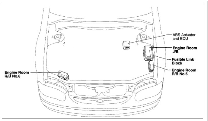

Most high draw devices use a fuse and relay, like fuel pump. They are generally located in engine compartment fuse/relay box.
The dealer or trusted garage can test the fuel pump using the diagnostic link in cabin.
Also check your owners manual.

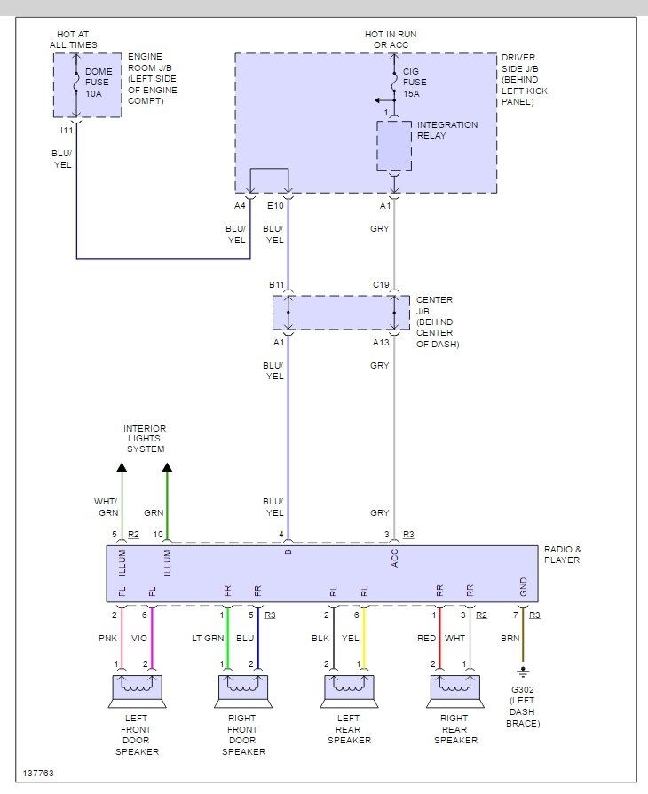

There is no power to my radio. Where is the radio fuse located?
Oct 22, 2018 at 1:36 PM (Merged)
MMPRINCE4000
  • 8,548 POSTS
Should be kick panel on drivers side by left foot or open door and look at end side of dash.

For which circuit? Fuses are in a fuse box under the hood. Fuse "links" used to be wires of a smaller diameter soldered into the wiring harness and had insulation that wouldn't burn. Now fuse links are large fuses that plug in. Often the very large generator fuse is bolted in.

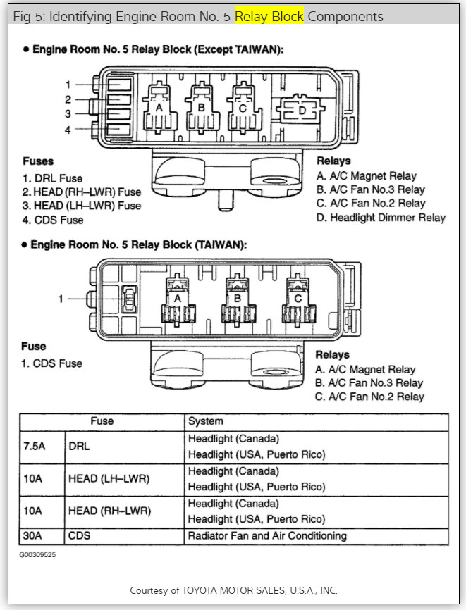

I just bought a 2002 toyota corolla radiator cooling fan dont turn on but i know they worked because i run a cable from the battery terminals and they turn on.. i replaced the sensor and some relays and still dont work and the car overheats in a period of time while running because the fans are not getting the signal to turn on..the engine main relay under the hood is missing could that be the problem? And if yes where can i get it i just cant find it...
