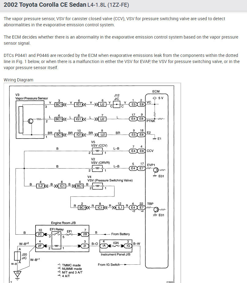

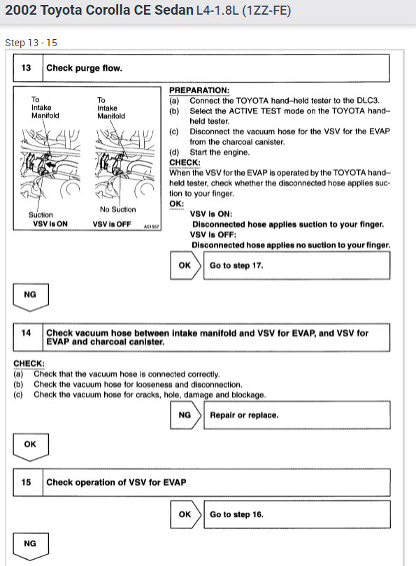

Those codes P0441 and P0446 usually gets triggered together due to EVAP system not being able to purge properly.
That's why when you fill up the gas tank it has hard time starting as the pressure inside the tank is higher that it should be.
This type of issue typically happens dues to having a faulty vapor canister purge solenoid.
This can also happen if the vapor canister is clogged as well.
https://www.2carpros.com/articles/how-emission-control-systems-work
https://www.2carpros.com/articles/evap-system-code-repair
I have attached the complete diagnostics for this trouble code.
