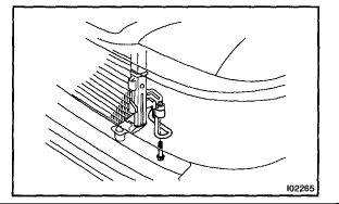

REMOVAL 1.DISCHARGE REFRIGERANT FROM REFRIGERATION SYSTEM 2.REMOVE RECEIVER
https://images.2carpros.com/forum/automotive_pictures/12900_c1_8.gif
3.DISCONNECT DISCHARGE HOSE Remove the bolt and disconnect the hose. NOTE: Cap the open fittings immediately to keep moisture or dirt out of the system.

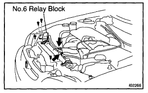

4.REMOVE 2 UPPER RADIATOR SUPPORTS 5.REMOVE NO.6 RELAY BLOCK SET BOLTS 6.DRAIN ENGINE COOLANT HINT: It is not necessary to drain out all the coolant. 7.DISCONNECT UPPER RADIATOR HOSE 8.DISCONNECT ENGINE COOLANT RESERVOIR HOSE 9.REMOVE CONDENSER

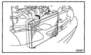

a.Lift up the radiator and push it toward engine.

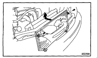

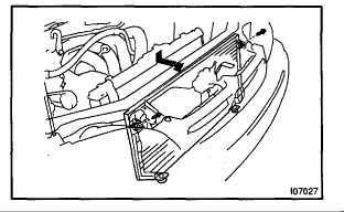

b.Remove the 2 condenser set bolts. c.Pull the condenser toward radiator and pull it upward. INSTALLATION
https://images.2carpros.com/forum/automotive_pictures/12900_c5_2.gif
1.INSTALL CONDENSER a.Install the condenser. b.Install the 2 condenser set bolts. c.Mount the radiator and install the 2 upper radiator sup- ports.
