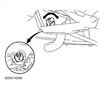

I own a 2001 Toyota Corolla which I recently took in to have aligned. I was informed that I needed to have a shim installed to correct a camber/toe problem on my left front wheel. When I received my before and after measurements back, I noticed that the toe was out on my right rear wheel as well, which was corrected. I had asked if the shim was installed on the right rear wheel instead. The salesman had a brief discussion with the tech and informed me that it was indeed installed on the left front wheel.
I may be wrong, but I was under the impression that alignment shims were only used to correct problems on the rear axle on a Toyota Corolla. So my questions are:
Is there ever a case where you can/would/need to install an alignment shim on the front of a 2001 Toyota Corolla?
Can you make toe adjustments to the rear of 2001 Toyota Corolla without shims?
Thanks in advance.

Ok your question isn't a cut and dry answer as it all depends on how you word it. Now there is a camber it available for the front of most all cars with struts now that could be what the mechanic was refuring to. As for the rear if the one of the rear lower control arms has an acentric bolt and washer then yes you can adjust toe without shims. Shims are sort of old school. For rear adjustment see pic below and for camber kit also see the second pic below.
https://images.2carpros.com/forum/automotive_pictures/249564_Graphic_196.jpg
https://images.2carpros.com/forum/automotive_pictures/249564_graphic1_4.jpg
