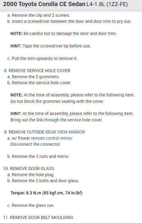

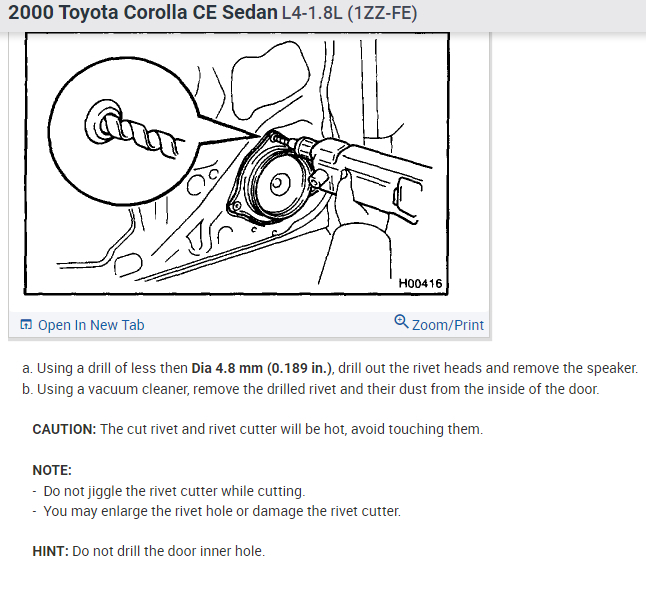

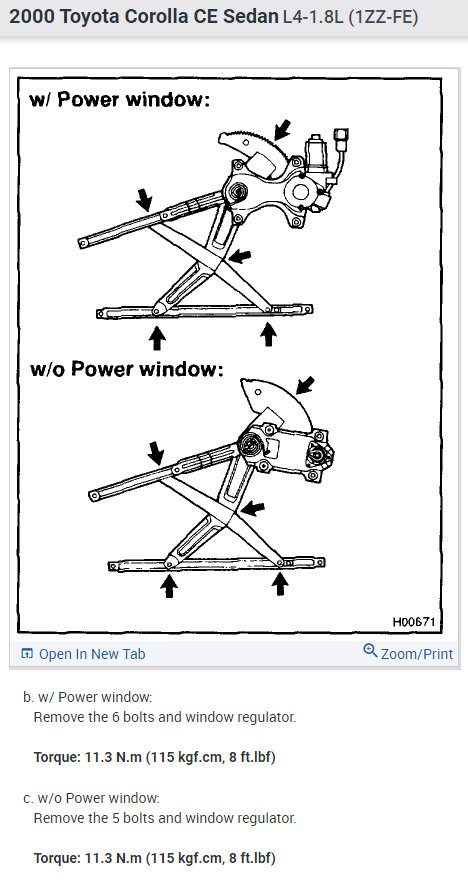

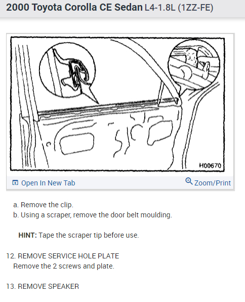

How do I replace the window motor?
2000 TOYOTA COROLLA
JDUYCAN41
May 30, 2009 at 11:32 AM
SQM
  • 6,383 POSTS

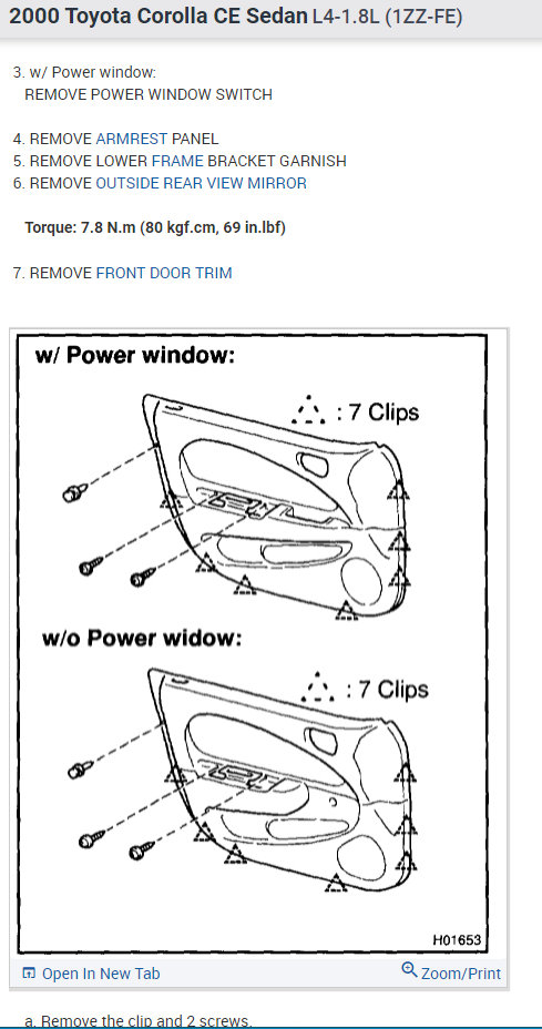

In order to replace the window motor you will have to remove the inner door panel.
The door panel can be removed using simple hand tools.
The panel is mounted by screws and plastic fasteners.
Here is a helpful article:
https://www.2carpros.com/articles/door-panel-removal
