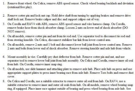

how difficult is it to replace ball bearings. the front right passenger side tire wobbles and i can wiggle it with my hands and i cant with the drivers side front wheel tire

https://images.2carpros.com/forum/automotive_pictures/261618_Noname_568.jpg
https://images.2carpros.com/forum/automotive_pictures/261618_Noname2_146.jpg
