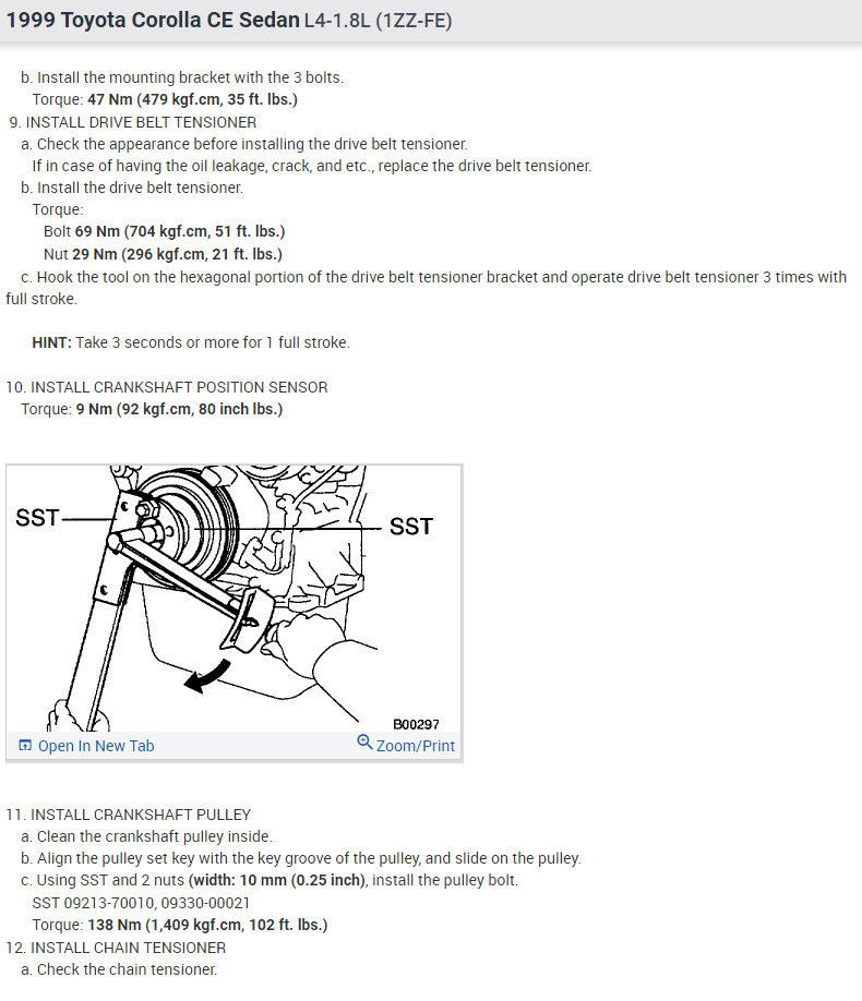

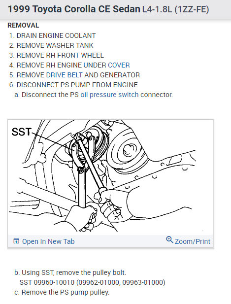

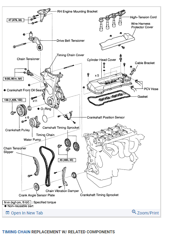

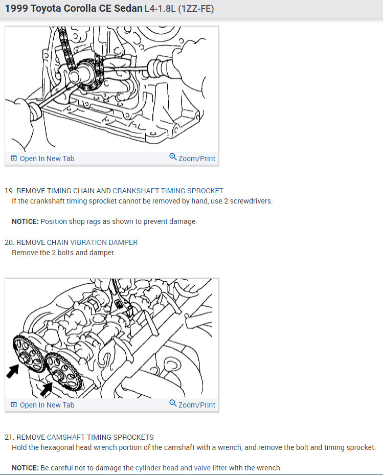

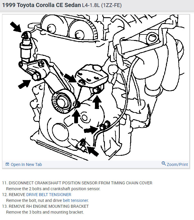

how often should i change my timing belt? How can I do it?
May 18, 2009 at 8:41 AM
SQM
  • 6,383 POSTS

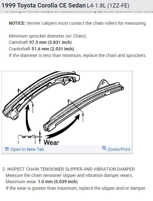

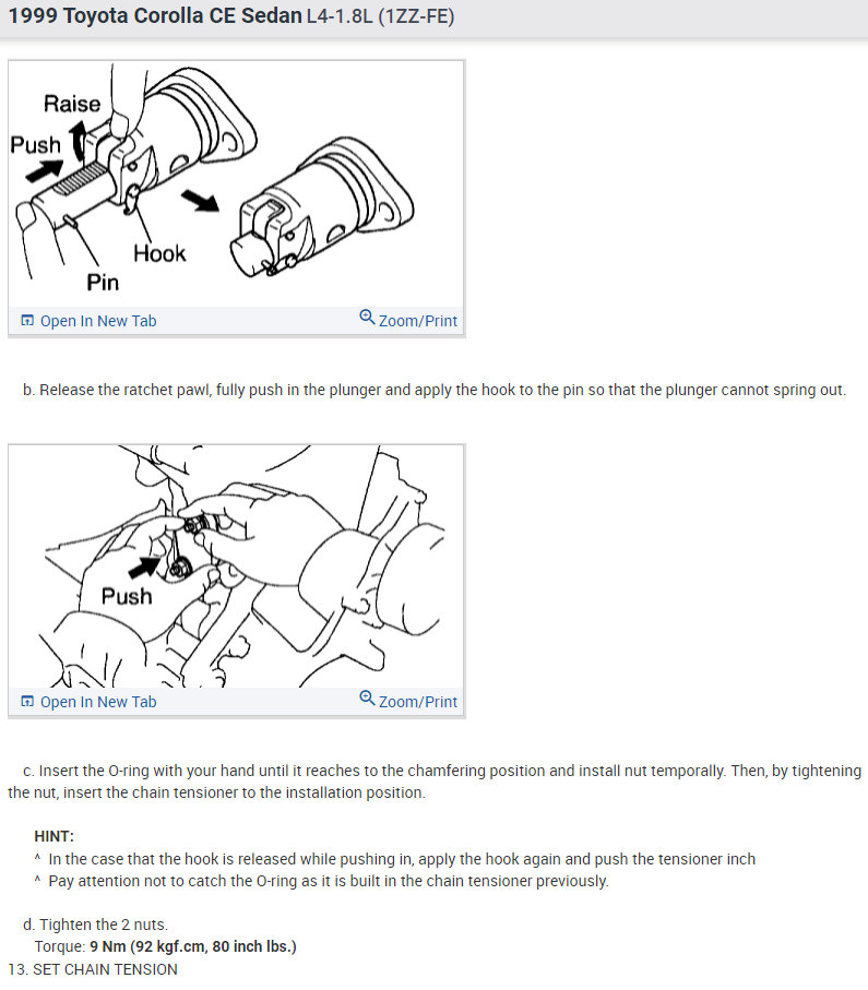

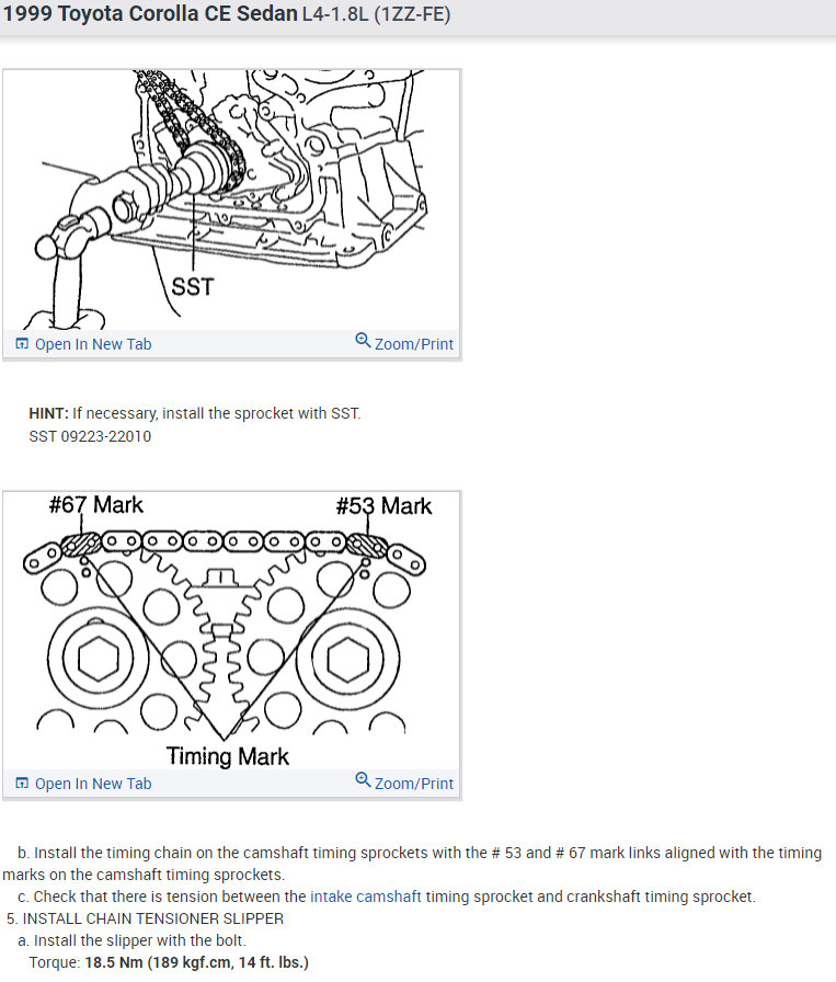

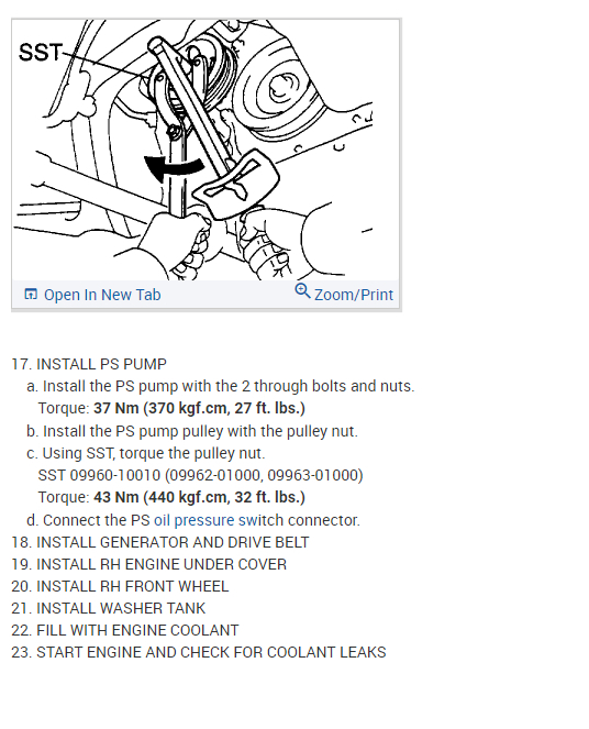

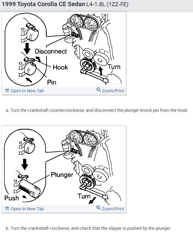

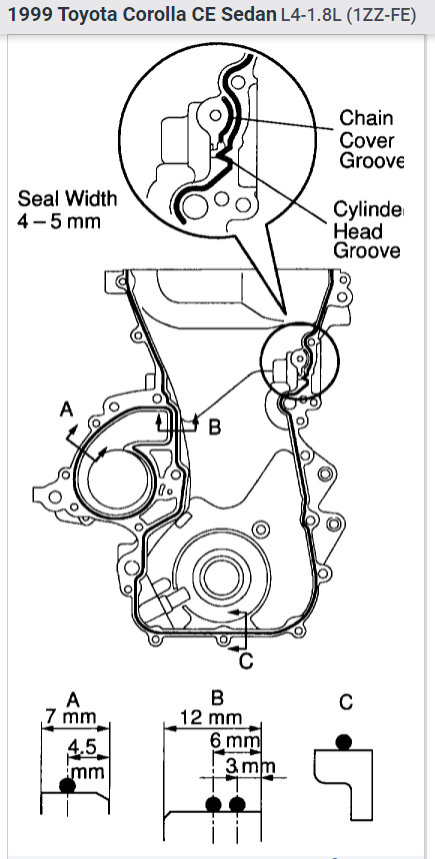

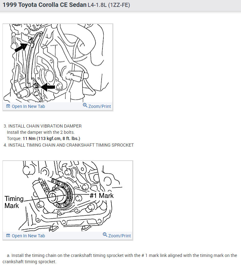

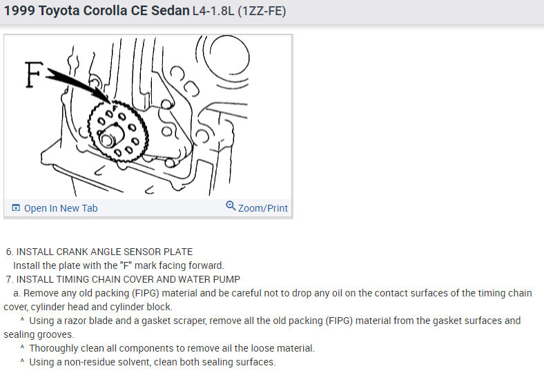

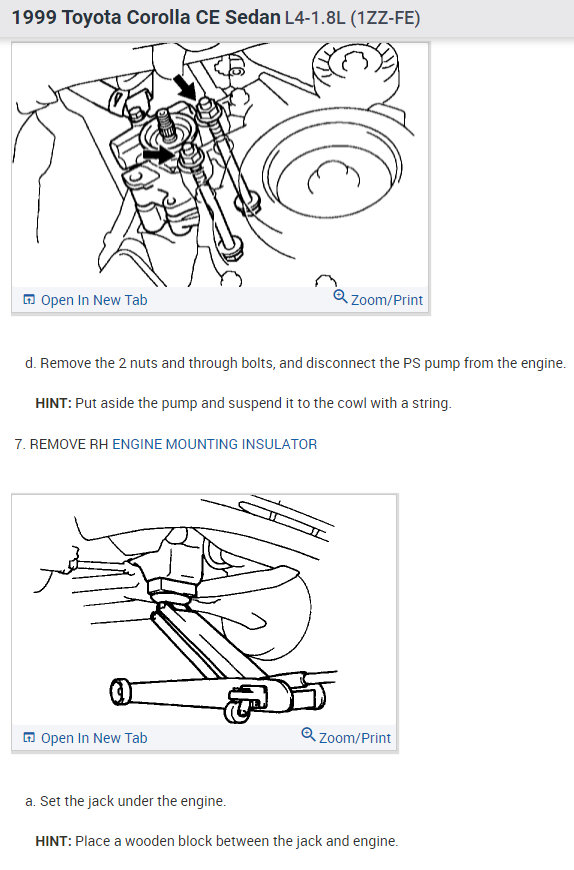

This vehicle is actually equipped with a timing chain. And unlike timing belts the chain is not a maintenance item. You will only need to change it if there is an issue with the chain.
So there is no regular interval for the timing chain.
