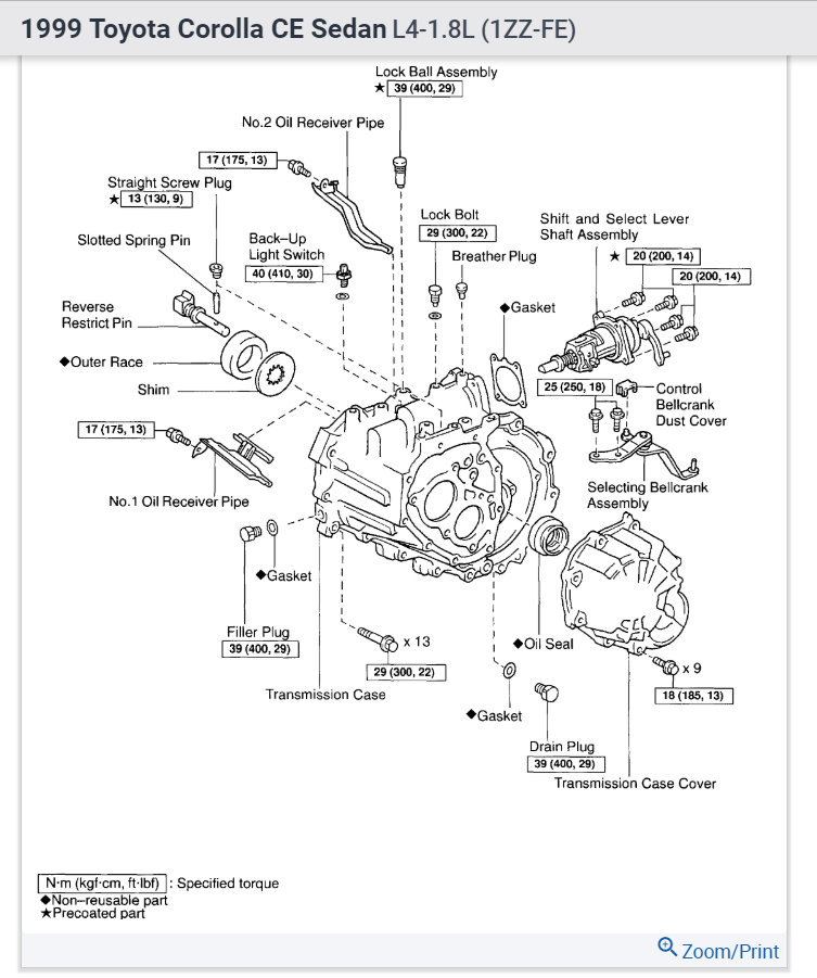

How do I replace the manual transmission oil in my Toyota Corolla 1999
What tools are needed and what is the procedure, any help would be greatly appreciated
Saturday, August 2nd, 2008 AT 2:44 PM
MMPRINCE4000
  • 8,548 POSTS
This guide will help you it is for a drain and fill transmission but you can see how to do it expect your will have a drain plug on the side. Here is diagram diagrams so help you get the job done.
M/T Fluid. 1.9L (2.0 Qt)
Grade. API GL-4 or GL-5
Viscosity. SAE 75W-90
