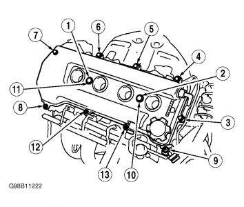

I thought that I stopped the oil from leaking but it is still leaking some from one side. It is the side via the driver, and it is only leaking there. I was wondering should I apply a thicker coat of sealant to stop this. When I put the cover back on should I let it sit there for a few minutes and then tighten them working from inside to the outer bolts.

Apply coating again, then tighten to specs and sequence provided below. Bolt/Nut with washer - 80in lbs (9.0)Nm without washer -97in lbs (11.0)Nm
https://images.2carpros.com/forum/automotive_pictures/261618_Graphic_4.jpg
