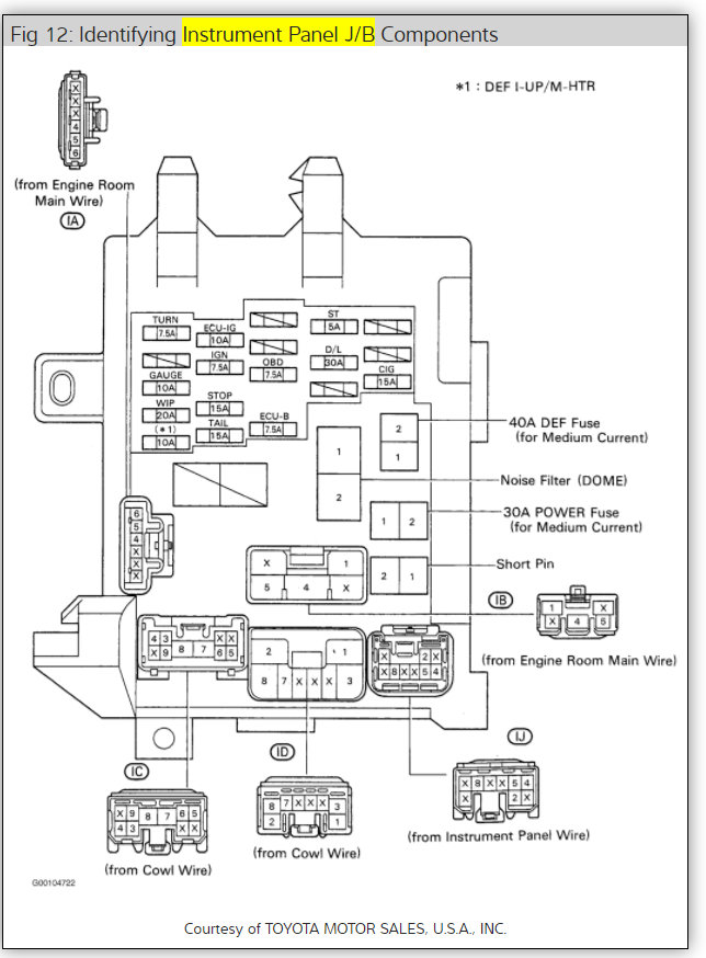

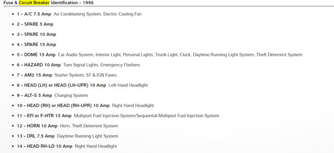

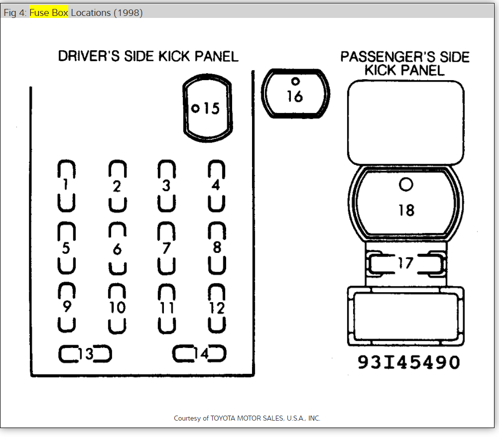

Why is it I have no power to my radio or clock I m not sure what it is iv checked the fuses in the outside fuse box and all seems to be good
Wednesday, August 25th, 2010 AT 11:09 AM
BLUELIGHTNIN6
  • 16,542 POSTS

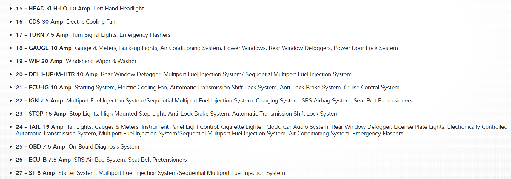

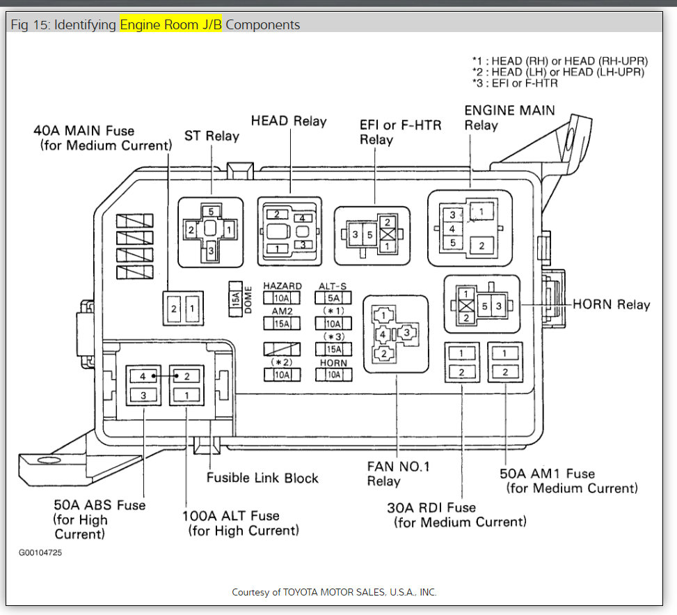

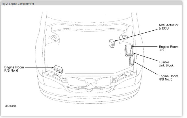

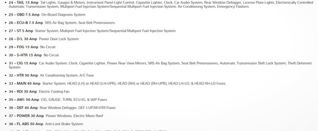

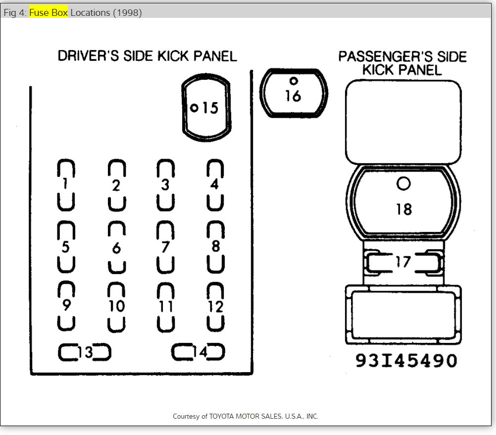

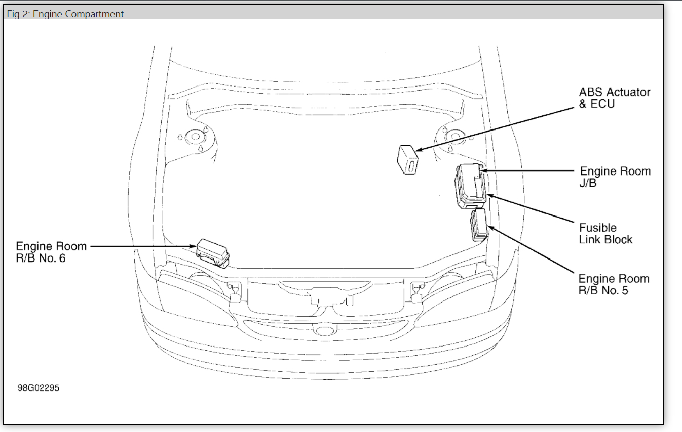

Check DOME fuse (10 amp) in left side of engine compartment fuse box. check CIG fuse (15 amp) behind left kick panel
Here is a guide to help you and the fuse location below.
