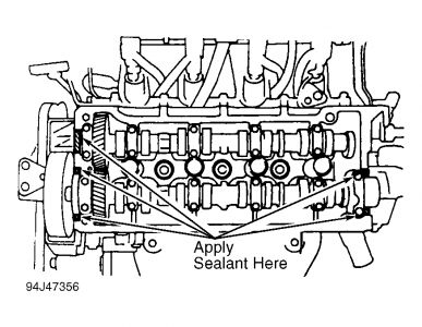

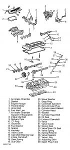

Does anyone have detailed procedures with pictures on how to replace the valve cover gasket? To the type of gasket used, parts used, lubricant used, etc. Anything and everything invovled on how to replace the gasket. Thanks for your responses.
Jan 16, 2009 at 2:00 AM
MMPRINCE4000
  • 8,548 POSTS
Hello, This guide will help walk you through the steps with diagrams below to show you on your car. https://www.2carpros.com/articles/replace-valve-cover-gasket Replace spark plug tube seals if they are hard or leaking. In some cases you may have to remove the timing belt cover for better access.
