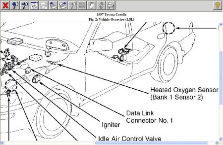

How many O2 oxygen sensors are on my Toyota Corolla engine. 1997 4 cylinder. When I look up the code P0136, it refers to the second sensor on bank 1 and where should I be looking for it.
Sep 16, 2008 at 1:50 PM
KHLOW2008
  • 41,814 POSTS
Hi LouP, It is the sensor after the catalytic converter.
https://images.2carpros.com/forum/automotive_pictures/192750_O2Sensor97Corolla_1.jpg
