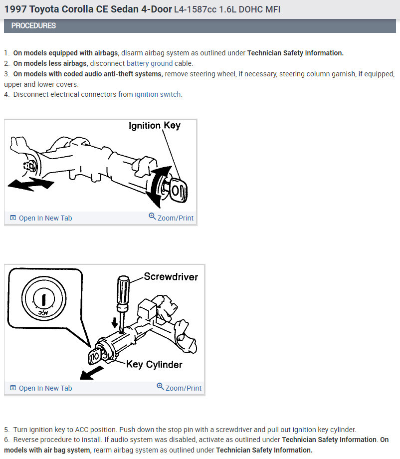

When I put the key in the ignition switch it wont move sometimes and I have to keep trying to turn it on. its getting worse how hard is it to replace an ignition switch yourself?
Nov 26, 2008 at 12:38 AM
SQM
  • 6,383 POSTS

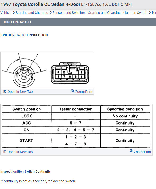

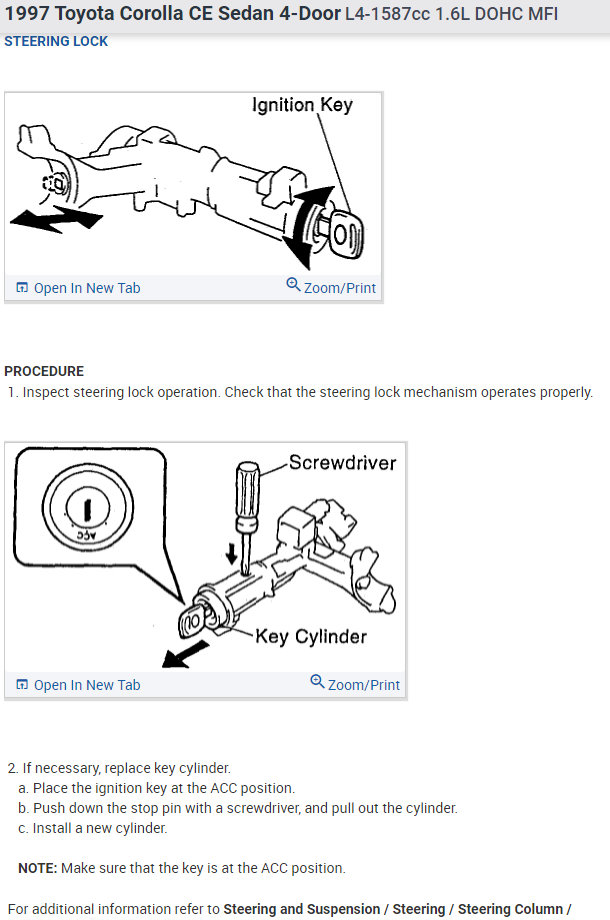

Replacing the ignition lock cylinder can be performed using simple hand tools.
Few things to keep in mind when changing out the lock cylinder:
Be sure to first disconnect the negative battery cable.
If your vehicle is equipped with anti-theft system, you will have to remove the steering wheel to get access.
https://www.2carpros.com/articles/steering-wheel-removal
I have attached the replacement procedure for the lock cylinder.
