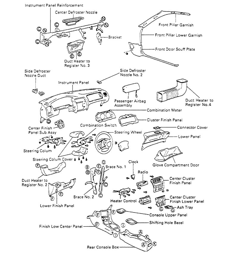

my trip odometer never moves off 000. what could be causing this and is it something that a "layman" like myself would be able to fix without spending a lot of money?

Hi tonyrlw,
The cluster needs to be replaced are diagrams to help. Check out the diagrams (Below). Please let us know what happens.
Jun 15, 2008 at 4:37 AM
TONYRLW
Thanks for the advice I got a used cluster and everything started working. I love this site. Cost me $70.00

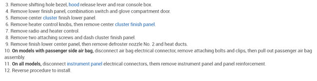

JEFFZEEMAN
How do I remove the odometer? I have checked both cables and the gearbox side. All in order.
Nov 29, 2018 at 4:23 AM (Merged)
KHLOW2008
  • 41,814 POSTS
To remove the meter cluster, you need to remove trims etc.
Unplug the cable and wire connectors.
Is the speedometer working?
Did you check if the cable is broken?
