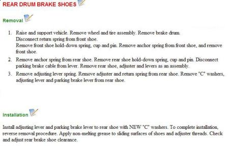

Could you please tell me how to replace my rear brakes. I know how to do the fronts which are disc, but I am lost when it comes to the rear that have drums. thanks

https://images.2carpros.com/forum/automotive_pictures/261618_Noname_788.jpg
