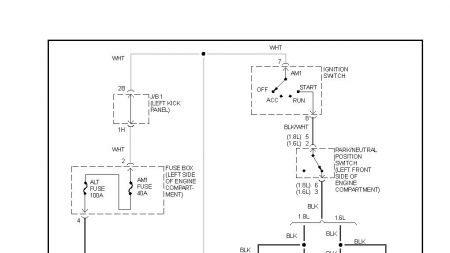

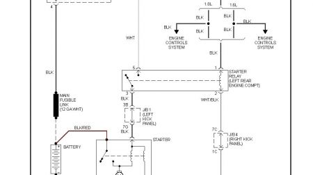

can anyone have the starting diagram for a 1994 toyota corolla. I am not geitting 12 VDC to the starter?
Please help
Tuesday, September 23rd, 2008 AT 12:22 PM
MECHANIC
75,992 POSTS
See below-Good Luck
