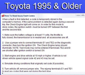

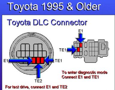

Is it possible to connect the DIAGNOSIS port to computer and have program to find out the codes?
Mar 8, 2008 at 8:41 PM
MERLIN2021
  • 17,250 POSTS
You don't need a computer...just a piec of wire and the ability to count the flashing light's flashes..
https://images.2carpros.com/forum/automotive_pictures/62217_95AndOlder2_2.jpg
https://images.2carpros.com/forum/automotive_pictures/62217_95AndOlder3_2.jpg
