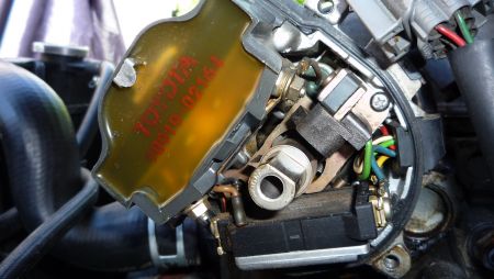

the car won't start... like I said in post all I did that made the difference is add a new cap and rotor (no brainer they go in only 1 way and can't screw it up) I checked and dbl checked the firing order and it is correct. It did start after I did the change but the next day, it would not even start. A motor head friend says that he thinks it's the coil shorting out and he actually had a friend that this similar thing happened too. Here is a pic of my distributor, everything looks okay but we know that can be deceiving.
what do you think?

I called a reputable mechanic I was recommended to by a friend. After a long chat with the mechanic guy, we came to the conclusion after all the checks (on the phone mind you) he suggested I replace the distributor and I opted for trying just the coil first. Long story short that did it !!!, I took it out for a drive (longest drive this car has had in months, LOL) and she performed great, God I felt so good about it I even took her up to get her washed, it's like having my faithful friend back!
Well gotta go play in the summer sun, so you take care and thanks for hanging in their with me, Good thoughts to you and all you know, my Bro.
