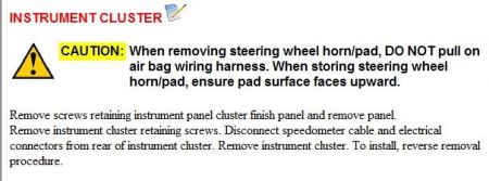

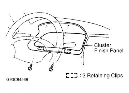

Have to remove instrument cluster to replace the bulb which is twisted into back of cluster assembly

How do I and what tools would I need to do this
