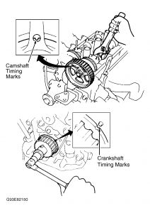

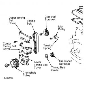

can you tell me how i change the motr belt. where are the marks in the motor of the polleys to install the belt in the correct time.

You will have to raise car, put on stands. Place engine at TDC #1. Remove the assy. belts and timing cover (take wheel off, of course). Remove right motor mount and support engine. Loosen tensioner and move out and retighten.
