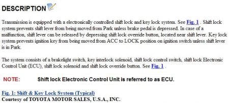

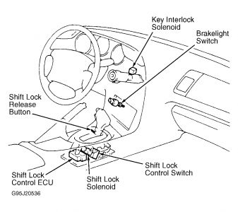

My car is stuck in park and I can not shift out of park.
SALLEKOTTE
  • 1993 TOYOTA COROLLA
  • 4 CYL
  • FWD
  • 170,000 MILES
My car is stuck in park, and I can not shift out of park.
Saturday, December 27th, 2008 AT 12:30 AM
MHPAUTOS
  • 31,937 POSTS
Hi there,
The shift lock system has failed, there are a number of components that may be faulty but there is an override that you can use to get you going , see pic and text.
