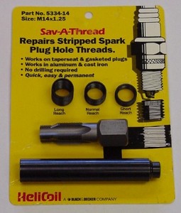

IS THERE A REPAIR KIT THAT COULD FIX A CROSS THREAD SPARKPLUG HOLD WITHOUT REMOVING ENGINE HEAD?

helicoil kit its about $35 like this one
https://images.2carpros.com/forum/automotive_pictures/99387_153118_072820051764_ExhibitPic_1.jpg

HI there,
there is a repair for this but you do need to drill out the old thread and re tap and insert a re coil thread, this will allow metal into the engine , and this is not recommended at all, just re cutting the old thread may result in a plug coming out while driving and doing more damage, i recommend removal of the head to repair this correctly.
