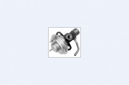

I was wondering if you knew where the location is for the EGR valve in a 1992 toyota corolla. I have read some places that they didn't have one that year but I think that is wrong. If you know where the location is, please let me know. Thanks for all your help.
James
Sunday, September 14th, 2008 AT 11:57 PM
  • 75,992 POSTS
Dunno where its located on this model but its normally in between the intake and exhaust manifold. It woud like this-see below
