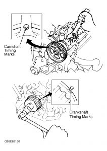

To add to the great advice from buddycraigg: There were two engines available, the 4AFE and 4AGE. The 4AFE has one camshaft cog:
https://images.2carpros.com/forum/automotive_pictures/108325_belt_marks_2.jpg
The 4AGE has two camshaft cogs driven by belt. You most likely have the 4AFE as the 4AGE is rare. The leak could be the front crank seal or oil pan, or oil pressure sender, but the oil could be leaking on other side and running down to front. There is an inspection hole in the timing belt cover (rubber, about halfway down) rmove and inspect the belt, if oil is present it is most likely the front seal. The timing belt, balancer, lower belt drive will have to be removed to replace it. Toyota also uses a sealant on the oil pan rather than a gasket, so that may also be the problem.
