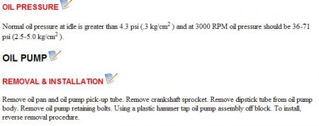

where is the oil pump located and how hard is it to change. what are symtoms of oil pump failure

Hi there, see text for oil pump removal, check oil pressure with a mechanical gauge, refer to specs, check for bearing knock and low supply to over head gear. mark (mhpautos)

Measure oil pressure with mechanical gauge first.
Oil pump is on front of crankshaft. You must remove oil pan and that requires raising the engine for access to rear pan bolts.
