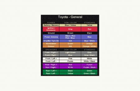

which wire is the hot wire for the power to turn on radio or cd player if installed?
