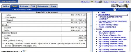

my engine makes sound! it keeps on ticking and ticking? please advise!!!!![img:0c57f254a6]http://www.2carpros.com/forum/automotive_pictures/280679_ToyotaAE9120Corolla5164_1.jpg[/img:0c57f254a6]

1990 Toyota Corolla V12 say what? V12 is this correct Check the oil pressure if okay-might want to adjust the valve lash.

V12?
The valve clearence is adjusted using adjusting shims, you need a special tool set to remove and install shims, J3341-A if memory serves.
Look at camshaft lobes for knicks, which will indicate excessive shim clearence. You may be better of just having the head rebuild.
