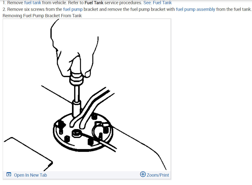

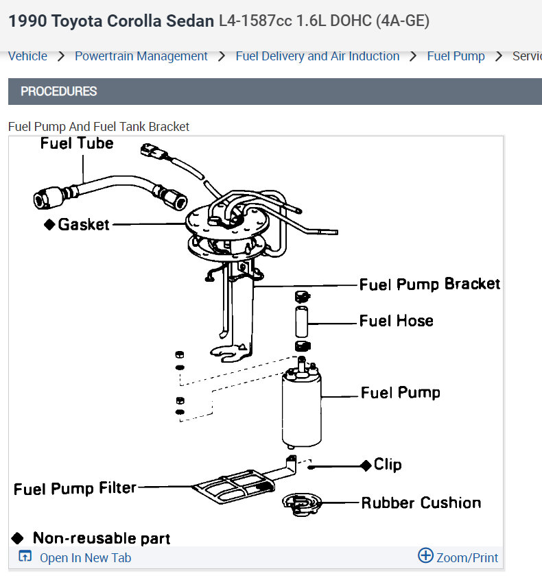

Where is the fuel pump located on a 1990 toyota corolla?

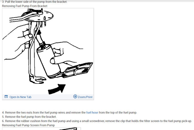

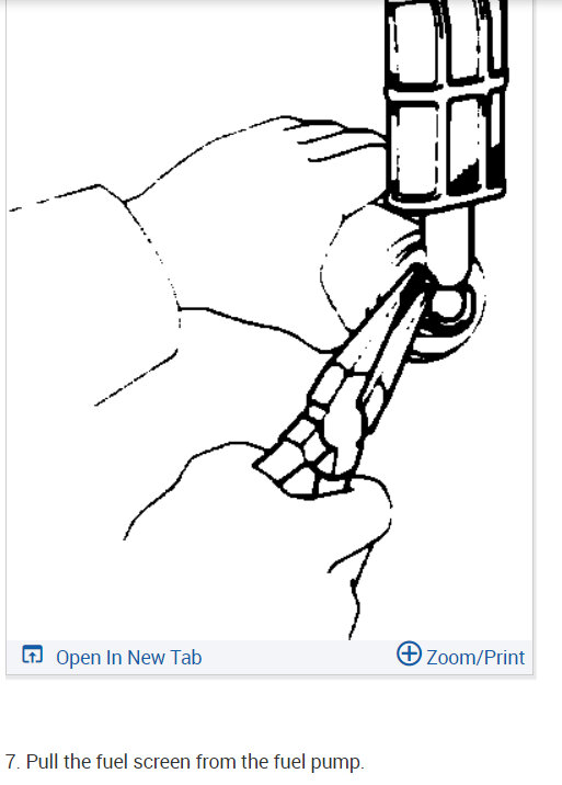

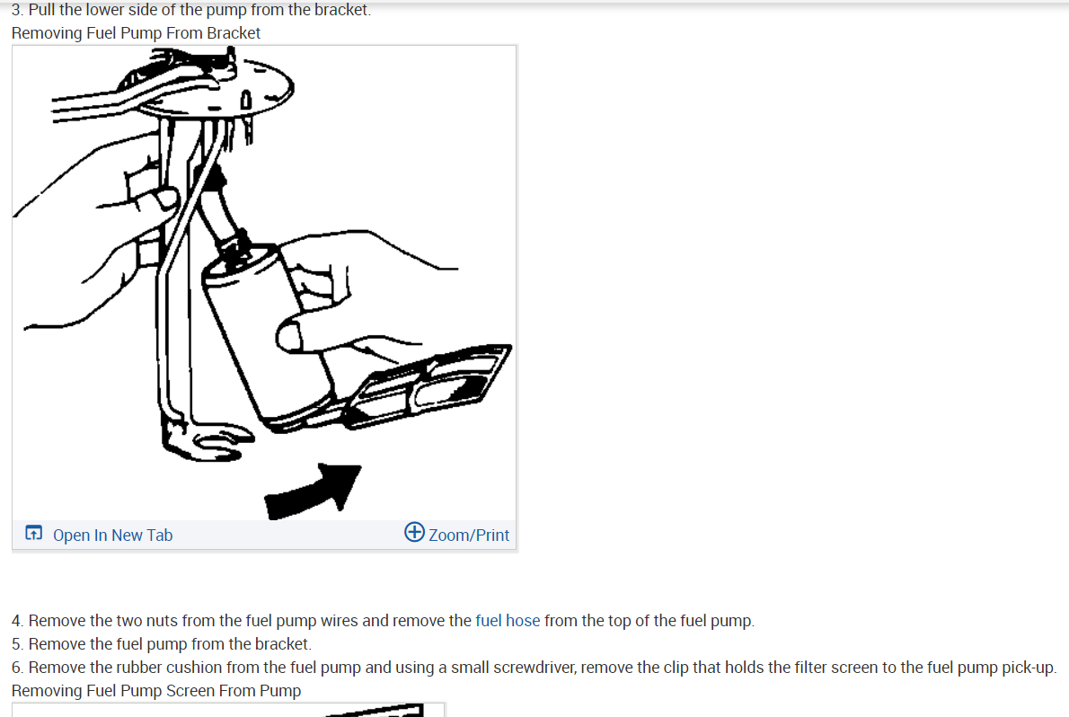

The fuel pump is inside the gas tank here is how to change it out. Check out the images (below). Let us know if you need anything else.
